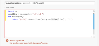

yovavzo
Thanks 🙂
Got Error - Invalid Expression
I've attached screenshot and the FGDB (missed it in the first post)
MehdiPira1
@yovavzo ,
You changed the code I provided, in your Code Block, that's why you're getting the error.

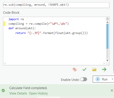

yovavzo
My bad
It worked 🙂
Many thanks
