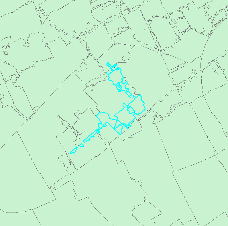

I have dissolved six position postal code areas (~ street part level) to create four position postal code areas (~ neighbourhoud level). Naturally, this has resulted in some strange shapes and multipart features (see below; selected area is a single feature).
I want to generalise these features and make them singlepart features, without losing the fact that the individual shapes share boundaries. Is there a way to do this?

I already did, and it doesn't. I need singlepart features, but I want them to be simplified versions of the current features, whilst making sure that full coverage is retained.

So, to hopefully make my problem a little more clear: I want to do a sort of combination of Multipart to Singlepart, Thiessen polygons and generalization is what I need; if possible. And I want to actually save the results of this operation to a new dataset, not let them be a representation of the data.
I hope this clarifies things! If not, please ask.

If the parts in the 4PPC feature should be merged into 1 part, and since 4PPC areas may not overlap, wouldn´t this create other "multiparts" (split other features) as shown below?
Maybe the Aggregate Polygons (Cartography, advanced license required) is worth giving a try...

So, I've drawn my idea of the solution: mutually exclusive generalised singlepart postal code areas that fill the entire area. I know my Paint-skills aren't all that, but I hope it illustrates my thinking a bit better. I must also add that I want the resulting areas to have roughly the same area as the original areas. However, as you can see in my picture, I am willing to accept quite a lot of generalisation.
Please let me know if there is anything else that I can do to explain my problem better.

well...I can honestly think of no algorithm that would produce that layout even with sharpened lines etc.  If the intent is to redistribute postal codes from scratch, then you could look into spatial allocation options or at least a Delaunay triangulation or Voronoi diagram would look attractive, even some network analyst allocation might be useful if drive times were important. Initially, it was six but I am seeing a massive number of fiddly bits which I am attributing to drawing.  If it is truly only six, editing manually would be the quickest.  Good luck.  Perhaps, some of the mathematicians over at the Mathematics Stack Exchange site or the stats people over at SE's Cross-Validated site might have a different perspective unclouded by GIS.  Good luck
