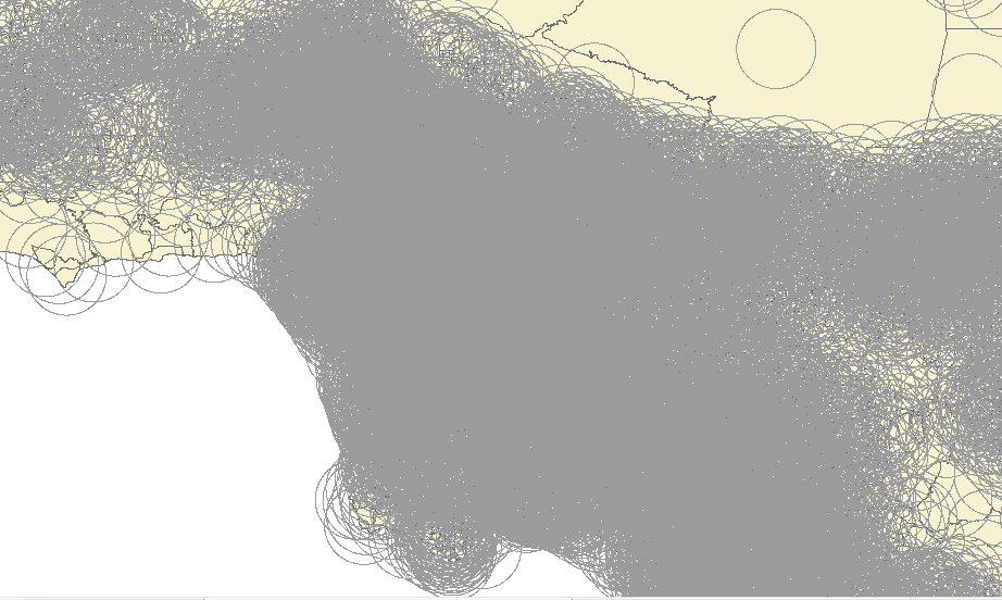

The short term solution is to reduce the size of the dataset. As in the picture below, there are many overlapping areas created by the buffers.
Maybe the output's data size is too large that the software could not handle...that could also be one of the reasons.

Holy moly! That is a lot of buffers! Did you get a chance to read some of the links that Sol posted? I would also advise googling the problem, as I saw a lot of possible reasons and solutions out there when I did so.
