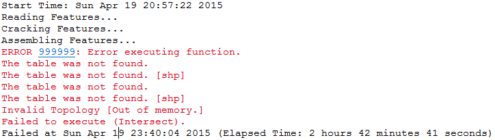

Hello,
I have been receiving error message during intersecting process (picture). I am trying to intersect between these two layers: 1) city boundaries and 2) buffers of those cities. Have anyone face this issue before? Please let me know how to solve it.
Thanks in advance!
Tom.

What are the input and output names? I ask because this looks like file naming may be the culprit - never name anything starting with anything but a letter and only use alphanumeric characters plus "_".
TomVo
by
Deactivated User
input names:
1) scag_2010_blockgroups
2) scag_2010_blockgroups_3mi_bffr_LA
Output name:
1) scag_2010_blockgroups_3mi_bffr_LA_intrsct

There are sveral limitations when using shapefiles as an output, such as field name length. Perhaps one of these is tripping you up?
They are listed here: ArcGIS Desktop
SepheFox
Deactivated User
Oh, just a thought--if the output location of these files is not a GDB, are you adding the .shp to the end of the file name?
SepheFox
Deactivated User
This is only a problem for feature classes, by the way. You can name shapefiles starting with a number.

Sephe,
Thanks for the info. This spatial analysis worked with 1 mile buffer but, for some reasons, it does not work for 3 mile buffer. I've tried to save the output in GDB as well but the problem still exists.
Interestingly, I performed a same procedure (intersect) for a different area with less records and it worked. I am thinking it is because I have too many records after intersecting the two layers? This may be the case..

How many records are there? You can quickly tell by selecting by location the parcels that intersect your buffers.

Worked:
1) scag_2010_blockgroups (239 records)
2) scag_2010_blockgroups_3mi_bffr_IM (239 records)
Did not work:
1) scag_2010_blockgroups (5697 records)
2) scag_2010_blockgroups_3mi_bffr_LA (5679 records)
At this moment, I am 75% confident that the cause of intersect failure is the size of my shapefile...

Hmmm, I don't know. That is not a particularly large amount of records. I regularly do this kind of analysis with 200k records.
