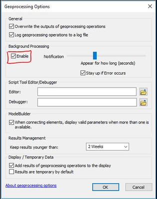

@deleted-user-s_pSF_cCqVzk ,
By default, tools are run “in the background” meaning that while a tool is running you can do other stuff with ArcMap.  When a conflict arises, the part of the code that does this (the background server) throws an exception (the actual technical term is “throws a wobbly”).  You can fix this by going to the Geoprocessing Menu and looking for “Geoprocessing Options”.  In the window that pops up, untick the Enable Background Geoprocessing:
The downside of this is that you won’t be able to do other work until the tool has finished its work.

THIS WORKS!
mohamed3Alaa
When it was deselected, the tool did its job
