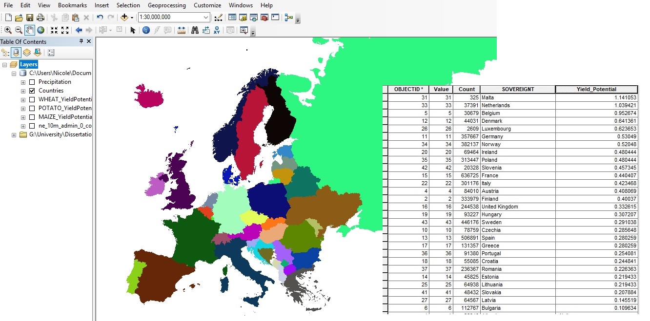

I am trying to create a map to identify land that is suitable for growing crops on. I have a raster which displays the yield potential for Europe, but is not divided into countries. I have also calculated the yield potential requirement that is needed to be achieved on the land in each individual country. I calculated this on an excel document but have also added it as a field on a vector layer with country polygons.
Is there a way for me to determine which areas are above the threshold level as the level varies by country?

Sorry I don't think I worded it very well, I don't have any kind of elevation data, by threshold I mean the yield potential that it needs to be above in order for that area to be considered viable to crop.

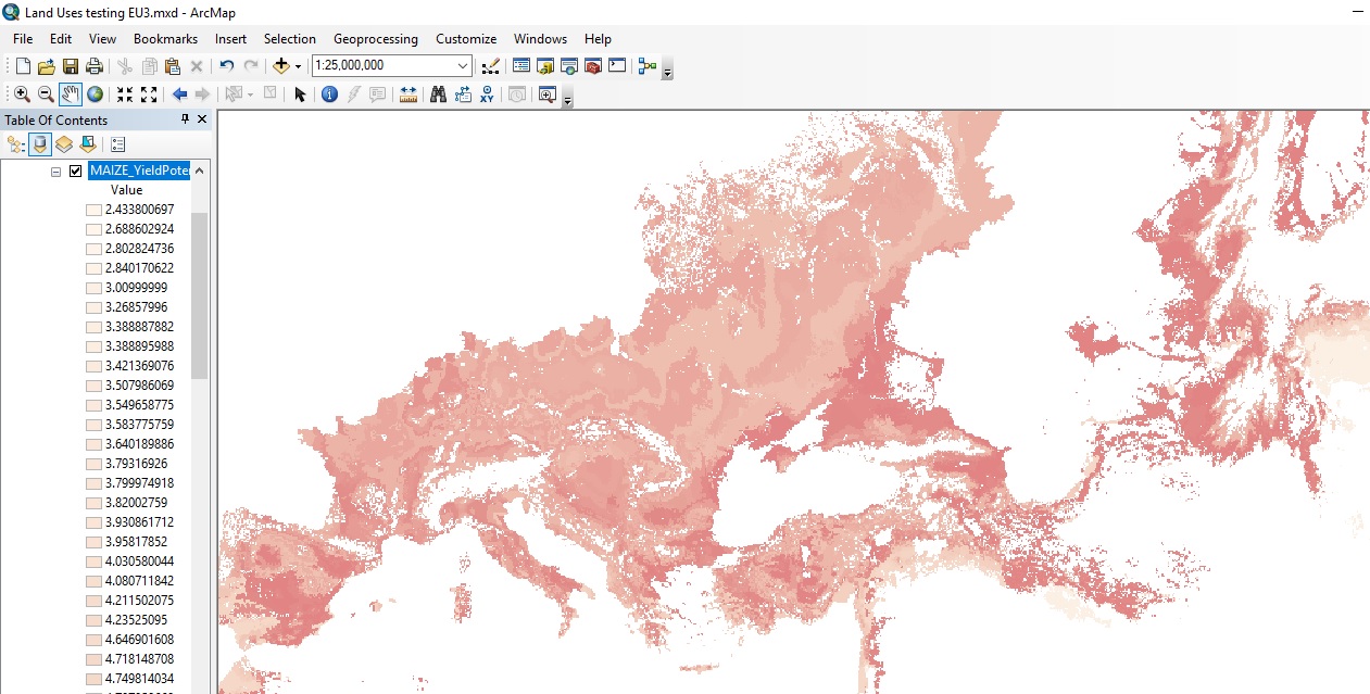

I've added some screenshots to see if that helps explain what I mean better, so I have one layer that is the country layer, and in the attribute table I have the yield potential values that need to be surpassed. Then the other is a raster layer that is shows the yield potential values of Europe. So essentially I need to subtract the values that I have for each country from the values on the other layer.

You need to convert the upper vector to raster and then subtract using the raster calculator or the Minus tool.  Alternately you could do a Zonal Mean using the upper vector as the zones and the raster as the data to summarize.  My guess is that you shouldn't produce a false sense of accuracy since the raster data is more generalized, hence averaging the values is better, and you can perform the calculation (difference) with the resultant values in the vector table.
