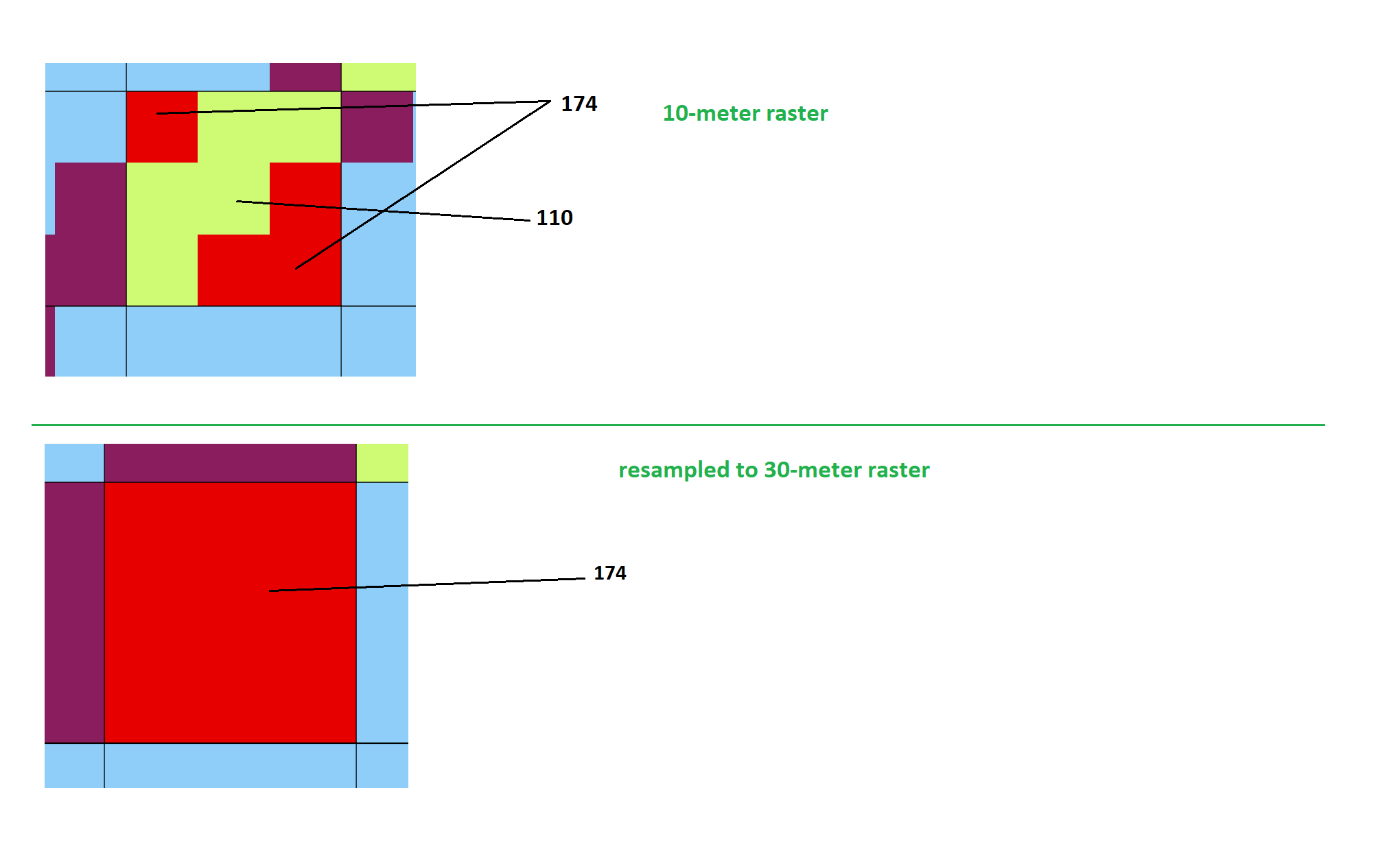

Hello! I am trying to resample a 10-meter raster to a 30-meter raster. I need to use the majority value that falls within those 30-meter grid cells. However, as I am QA'ing the outputs, it looks like it does not always pick the majority value. Now I am confused on how the majority function actually works... In my example below, there are 5 cells with a value of 110, however after I use majority resample, it picks the 174 value instead? Why is that?

Correct, the Majority option will use a 4 by 4 moving filter window to process each pixel.  This usually means the 16 nearest pixels.

Majority—Calculates pixel value using the majority pixel value in the 16 nearest pixels. NoData pixels will remain unchanged in the output raster dataset.

Here is a zoomed out extent. The black outlines are the 30-meter grid cells.

The nearest 16 would pick up the central block of 9, but I don't know the actual values of the purple cells and which ones it will pick up or what the cell weighting (if any) would be.

why does it use the nearest 16 cells? shouldn't it be dependent on the input and output cell sizes? I don't think I understand that reasoning.

Thank you for the clarification! I did not realize Resample uses a moving filter window. It looks like I need to use Block Statistics as David Pike had mentioned above.
