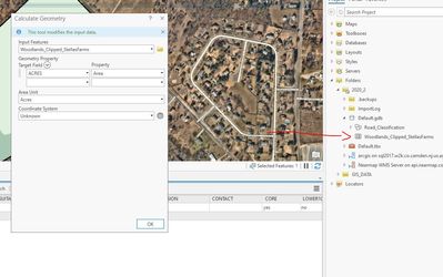

I am realizing as I am submitting this question, that other people have the same concerns with Calculate Geometry not working in Pro version 2.7. See below for the error that I am receiving. I have never had issues before using this geoprocessing tool, and it's not like it's a complicated process. Can anybody help me figure out what my error is trying to say?
I still believe after seeing multiple concerns about version 2.7 with this tool, that there may be a bug.

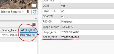

Thank you. Here's an update:
I created a new test field for acres and ran the tool exactly the same, and it successfully ran, which is great. However now, you can see below in my screenshot that the amount that was calculated vs. the popup with the field is a totally different amount. Same data, same field, different numbers. The acres that were also calculated are incorrect - it is really 20.13 acres. So lots of issues definitely going on here. I believe I saw someone else having an issue with incorrect calculations, so I'll see if I can find that again.
DanPatterson
MVP Esteemed Contributor
It seems to be missing the something for sure. a feet vs meters thing?
In any event, I always make sure that my tables don't display the alias but rather the actual field name.  That issue has come up a few times as well.

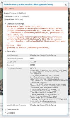

Try the Add Geometry Attributes tool for a comparison as well
... sort of retired...

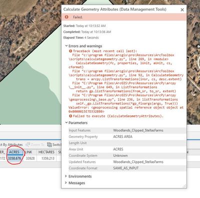

KamillePreto
Thank you. This test failed as well.
DanPatterson
I found the lines in the code
# --- from addgeometry attributes
        self.shapeDict = {"POINT": 1,
                          "MULTIPOINT": 1.5,
                          "POLYLINE": 2,
                          "POLYGON": 3,
                          "MULTIPATCH": 4, }
        self.shapeDim = self.shapeDict[str(desc.shapeType).upper()]
.  Do you have multipart polygons?
Z or M enabled?
It is failing on the shapeType not being in the dictionary...
