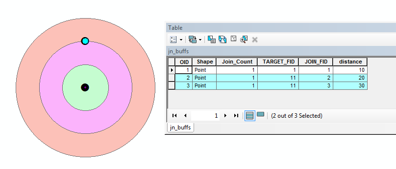

So if you have Multiple Ring Buffer boundaries defined at say 20, 50, and 100 miles, which 'Ring' does a point at exactly 50 miles fall in? Are the boundaries inclusive or exclusive limits? I have scoured the internet for an answer and cannot find a single post that addresses this.

The boundaries are shared, it's not one or the other. A point on the boundary intersects both buffer geometries.

I think I misunderstood your question though. I believe if you did something like a spatial join, your point at 50 miles would create two spatial join records, one for each buffer polygon. That would leave it up to you to filter out your results. The thing that bothers me about this idea is that I have done such a thing many times, and I don't remember any issue with counts not adding up on the borders of buffers. If you have such data handy, it would be a simple thing to test.
DarrenWiens2
MVP Alum
Yes, the point on the boundary creates two spatial join records.

The more I think about this and remember...  Yes, if you do a spatial join with a point on the border of two multi-ring buffers, your results will have records for "hits" with both buffers if you choose the parameter JOIN_ONE_TO_MANY. If you choose the parameter JOIN_ONE_TO_ONE, ArcGIS will rather arbitrarily choose one or the other, and you will only have one record. Is that the sort of thing you are wondering about?

<beating a dead horse>
I'm guessing you want to make your legend something like the following, as you would do with most numerical classifications:
0 <= x < 20
20 <= x < 50
50 <= x < 100
but as (I think) we've shown, the "truth" with multiple ring buffers would be:
0 <= x <= 20
20 <= x <= 50
50 <= x <= 100
</beating a dead horse>
