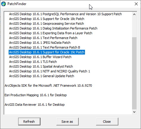

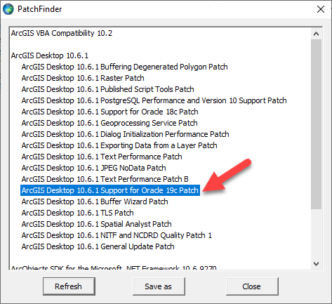

  • ArcGIS Desktop/Geodatabase 10.6.1 with the "Support for Oracle 19c Patch" installed
I don't think I need to patch ArcGIS Enterprise as it is at 10.8.1, so it looks like I have all the Esri patches installed that I will need.
