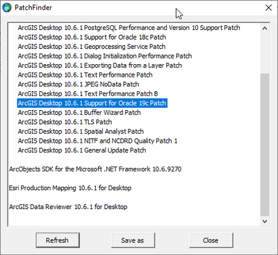

We want to upgrade Oracle to 19.3
Our current environment looks like this
  • ArcGIS Enterprise 10.8.1
  • Oracle Database 12c Release 12.1.0.1.0 - 64bit Production
  • ArcGIS Desktop/Geodatabase 10.6.1 with the "Support for Oracle 19c Patch" installed
I don't think I need to patch ArcGIS Enterprise as it is at 10.8.1, so it looks like I have all the Esri patches installed that I will need.
