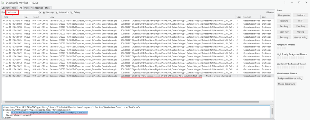

Regarding not being able to create a database view with CAST in the WHERE clause, that is interesting because CAST works in the Select By Attributes tool, which of course is the WHERE clause:
CAST(t_date AS CHAR(20)) IS NOT NULL
I looked at the Diagnostic Monitor in ArcGIS Pro to see what SQL query Pro sends to the database when using CAST in Select By Attributes. I had wondered if it was doing something special, such as wrapping something in a subquery or outer query, which can be an effective workaround in some cases.
Examples:
But no, the query looks normal.
SELECT OBJECTID FROM species_records WHERE CAST(t_date AS CHAR(20)) IS NOT NULL
I tried using that exact SQL to create a FGDB database view. But it failed, just like previous attempts to use CAST in the WHERE clause of a FGDB database view.
I also tried adding an extra column to the SELECT clause, just in case it didn't like only selecting the ObjectID. But that didn't work either.
SELECT OBJECTID, t_species FROM species_records WHERE CAST(t_date AS CHAR(20)) IS NOT NULL
ERROR 160195: An invalid SQL statement was used.

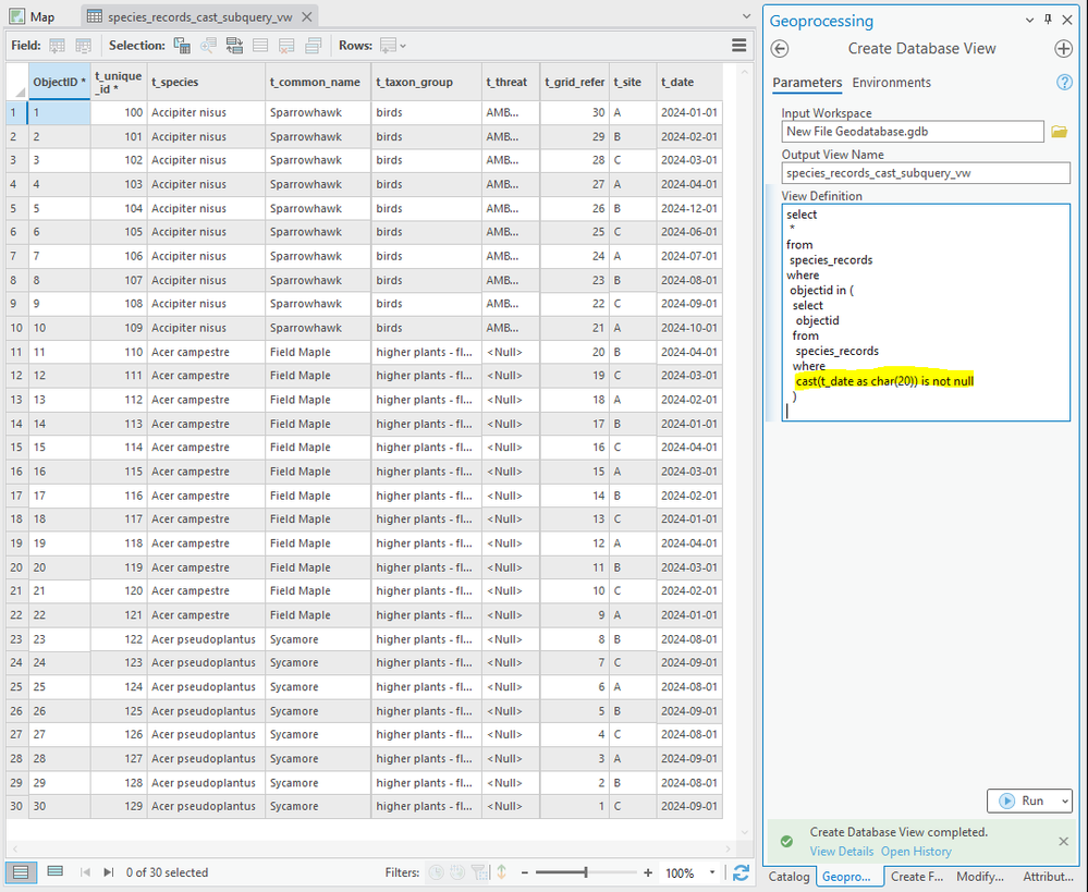

Bud
Legendary Contributor
Surprisingly, wrapping the WHERE clause CAST in a subquery seems to work. I'm able to create the view.
select
from
    species_records
where
    objectid in (
        select
            objectid
        from
            species_records
        where
            cast(t_date as char(20)) is not null
