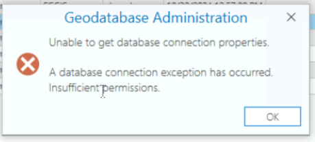

We have SQL Server 2022 and in ArcGIS Pro 3.3 when we try to disconnect a user from the connection, it fails with the below error:
Through some research we got to know that DB owner should have View_Definition permission which we granted. Issue is still observed.
What else are we missing here?

Hi @Yogesh_Chavan, is your geodatabase administrator a user named sde or a login that is mapped to the dbo user in the database that contains the geodatabase?  The user must also be added to the processadmin server role to disconnect users.

Thank you @JakeSkinner !!
