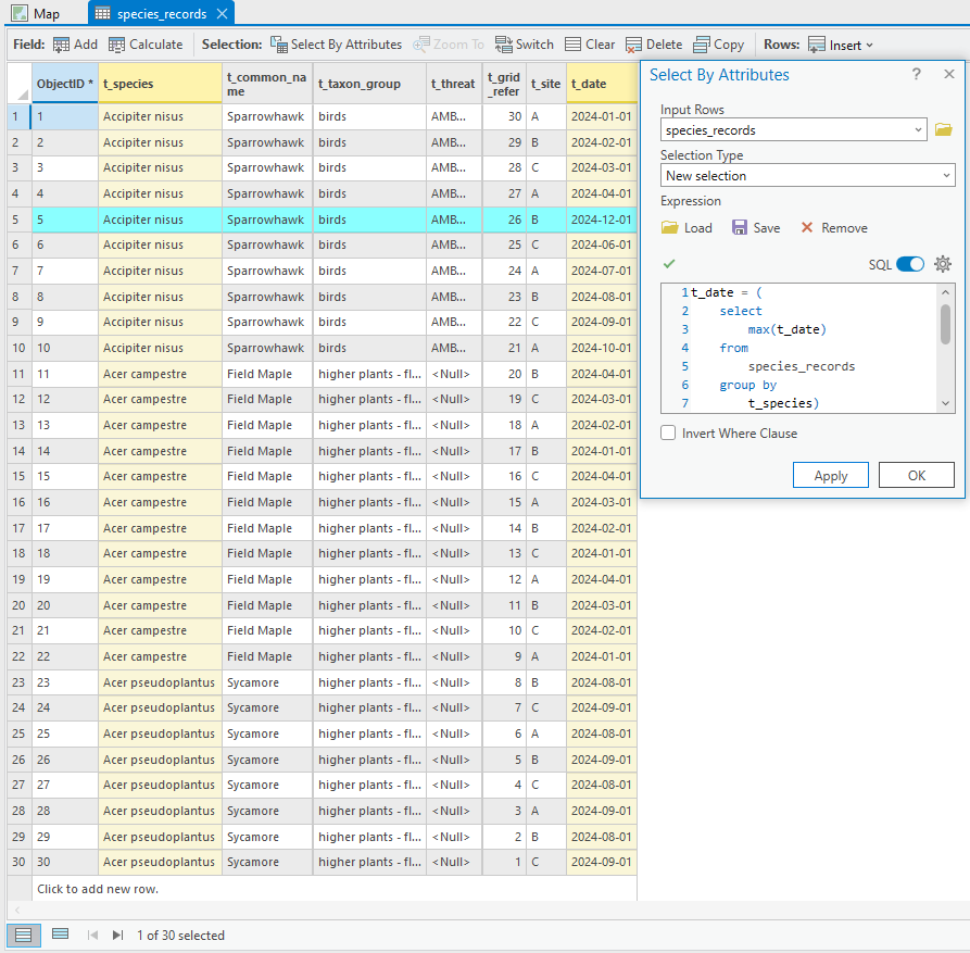

I'll use the SQL expression above to try to select the latest row per species group. The result looks like this:
t_date = (
    select
        max(t_date)
    from
        species_records
    group by
        t_species)
That's not the result I was looking for.

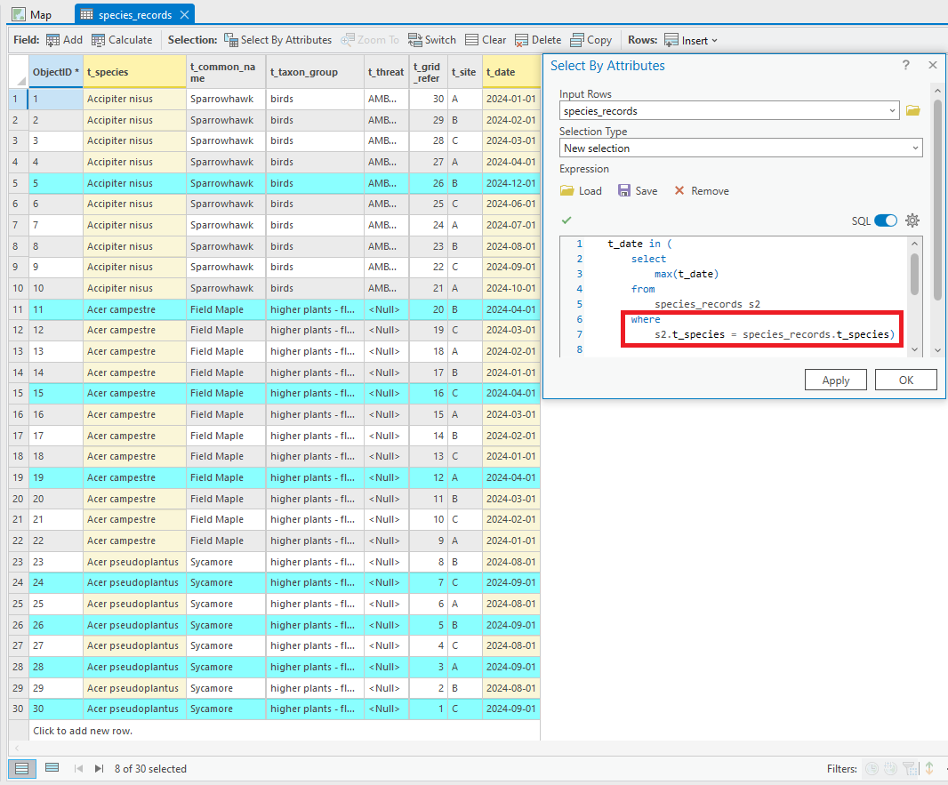

This would be the result I'm looking for:
t_date in (
    select
        max(t_date)
    from
        species_records s2
    where
        s2.t_species = species_records.t_species)
What am I missing in that article?

JoshuaBixby
MVP Esteemed Contributor
Wow, whoever wrote that Support article needs to brush up on their SQL.  The logic of that SQL query is flawed because it could select multiple records for a given set if a set had a non-maximal date that happened to be a maximal date for another set.  Usually when people are selecting maximum per group they want only the maximum selected (or multiple if maximum is shared), and not the maximum and maybe some others as well.

The screenshot with the desired outcome appears to be greatest-n-per-group with "n" being 1 where the greatest has ties.  Are you interested in greatest-singular or greatest-n?  If the former, it simplifies the situation a bit.
UPDATE:  The following is a generalized greatest-n-per-group that supports ties in SQLite.  I can't speak to its performance, and it is a bit ugly with the nested subquery (nesting is forced with a window function), but it works and is a place to start:
