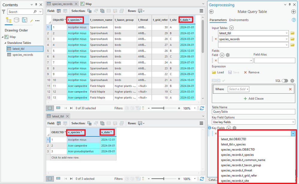

It's my understanding that date fields can't be used in joins between tables/FCs in the Make Query Table tool. The Key Field Options parameter excludes date fields from the pick list.
Could that be changed so that date fields are supported in joins? For example, join on SPECIES=SPECIES and DATE=DATE.

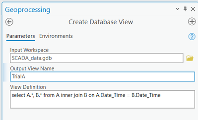

did you happen to try Create Database View and see if that work? I did a quick test with some made up datasets and it worked for me (fingers crossed).
as you know this tool allows you to use sql statements to create a view inside a file gdb.

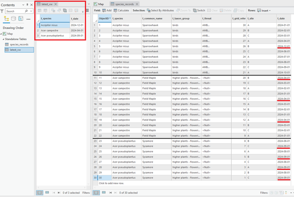

That view works as expected in the attribute table:
I now have the latest records per species in LATEST_VW.

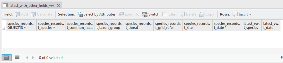

Problem:
The view doesn't return any records:

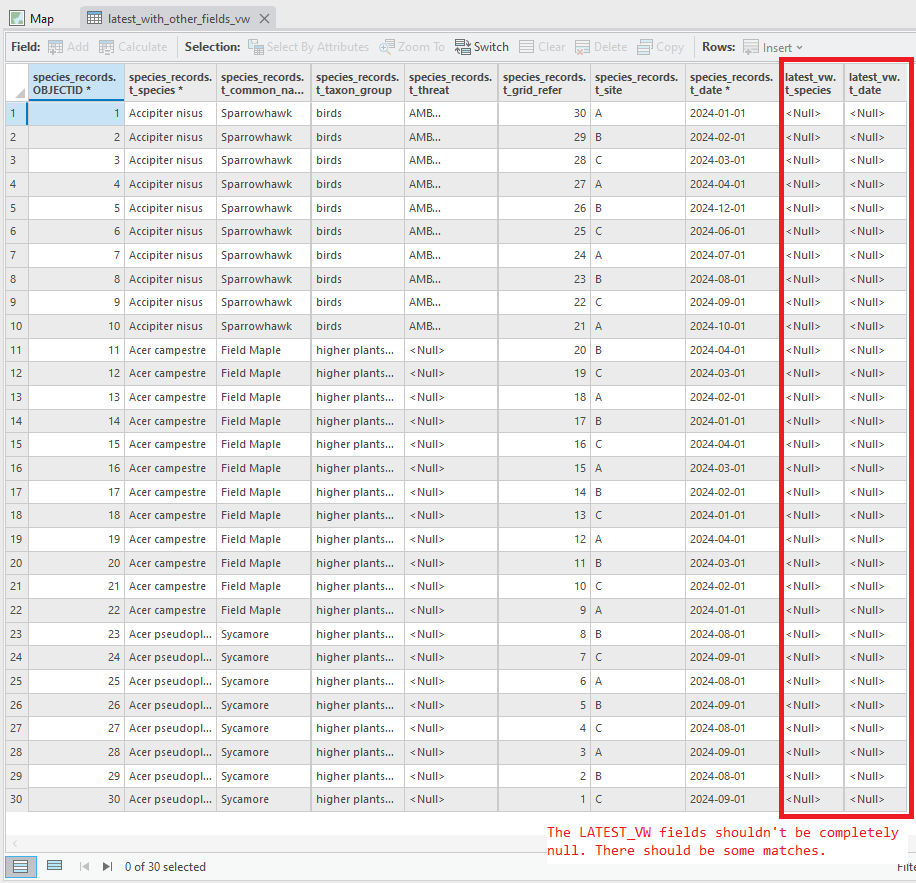

If I change the join type from INNER JOIN to LEFT OUTER JOIN, I can see that the join wasn't successful; it just produces nulls for the LATEST_VW fields.
--latest_with_other_fields_vw
select species_records.*, latest_vw.* from species_records left outer join latest_vw on species_records.t_species = latest_vw.t_species
and species_records.t_date = latest_vw.t_date

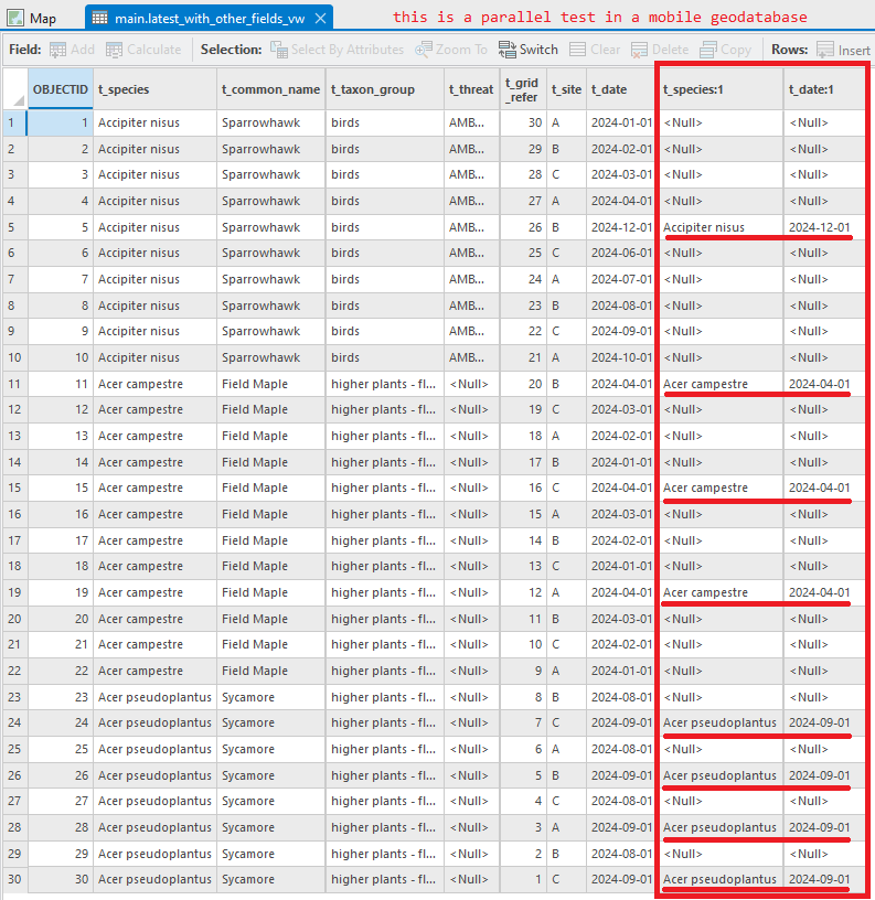

It should look like this (a parallel test in a mobile geodatabase):
(In the future, I could easily exclude the rows that aren't matches by using an INNER JOIN instead of a LEFT OUTER JOIN. Or in a definition query.)

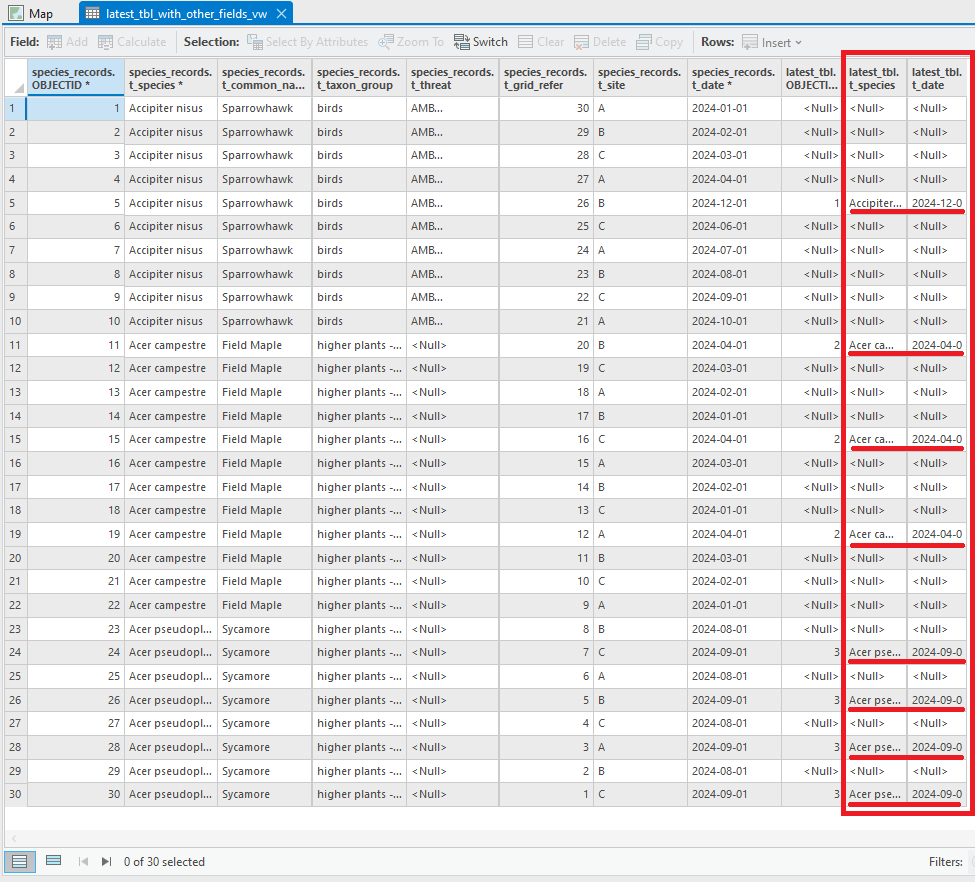

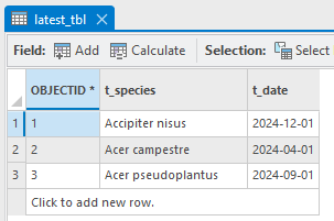

My FGDB logic should work. I can prove it by converting LATEST_VW to a table called LATEST_TBL (copy the view in Catalog and paste it; it will be pasted as a table, not a view).
In a new view called LATEST_TBL_WITH_OTHER_FIELDS_VW, I'll join using LATEST_TBL instead of LATEST_VW.
--latest_tbl_with_other_fields_vw
select species_records.*, latest_tbl.* from species_records left outer join latest_tbl on species_records.t_species = latest_tbl.t_species and species_records.t_date = latest_tbl.t_date
That worked as expected. There are matches:
