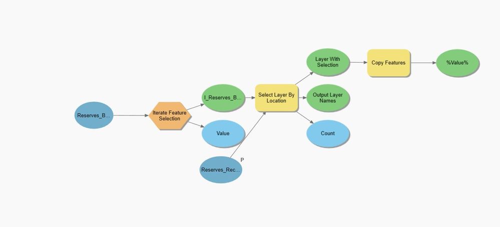

Hi,

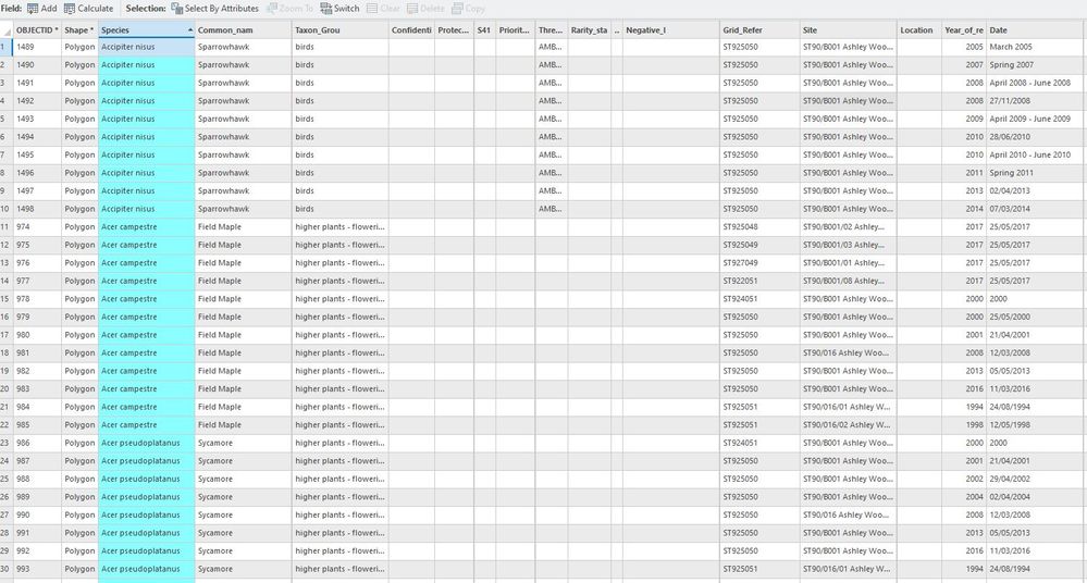

I have built the model in the picture, which works fine. But the next step I want to do is for each of the new feature classes that are created, I want only the most recent record of each unique record from the species field. But I want all the associated fields to come through into the new feature class. See table picture below, for example I only want the most recent record of Sparrowhawk.
I am not sure how to do this and if I can add it into the model as part of the process?
Thanks

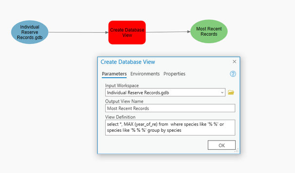

If I was to create a database view, just struggling with correct syntax to go through the feature class in the file geodatabase what do put after the FROM part see picture. Or am I completely way off!
Thanks
DavidPike
MVP Notable Contributor
Ah I tried a FGDB view and couldn't subqueries with GROUP BY working.  I'd really recommend what @RichardHowe suggested as the most practical way.

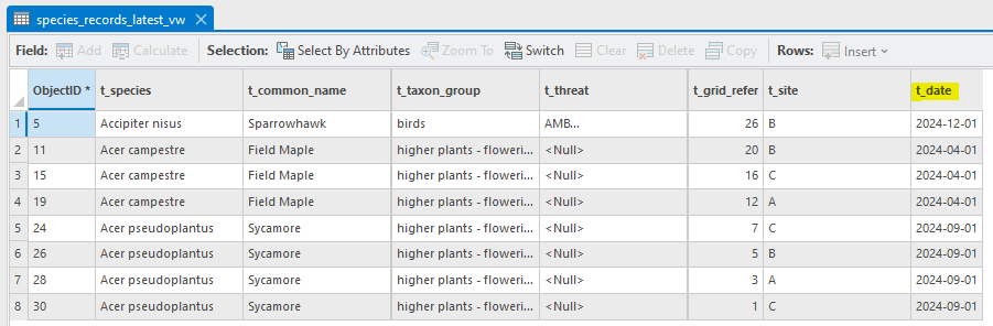

I haven't found a way to do it in a SQL expression. But I got a FGDB database view to work.
I thought I'd tried this approach previously without luck. But I guess I must have done something differently this time because it works now.
1. Load this sample spreadsheet into a FGDB:
https://community.esri.com/t5/arcgis-pro-ideas/fgdb-database-views-view-that-selects-from-an/idi-p/1...
2. Create this database view:
--species_records_latest_vw
select
from
    species_records
inner join
    (select
        t_species,
        max(t_date) as t_date
    from
        species_records
    group by
        t_species) l
    on species_records.t_species = l.t_species
       and species_records.t_date = l.t_date
For my notes, the SQL in brackets is a derived table, not a subquery. Is the SQL in brackets a subquery?
Result:
Unfortunately, the query doesn't break ties when there are multiple rows per species with the same date.

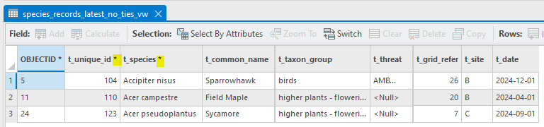

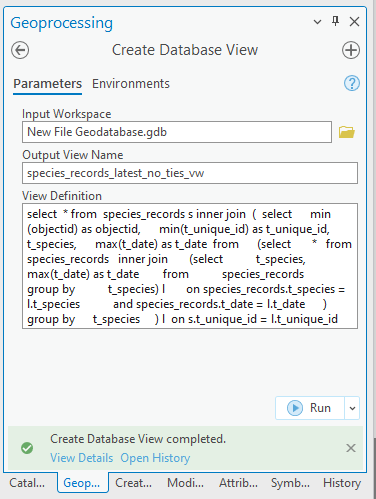

Update:
I got a FGDB database view working that breaks the ties.
Again, I thought I had tried this previously and failed. But it seems to be working now.
select
from
    species_records s
inner join
    select
        min(objectid) as objectid,
        min(t_unique_id) as t_unique_id,
        t_species,
    from
        (select
        from
            species_records
        inner join
            (select
                t_species,
            from
                species_records
            group by
                t_species) l
    group by
        t_species
    ) l
    on s.t_unique_id = l.t_unique_id

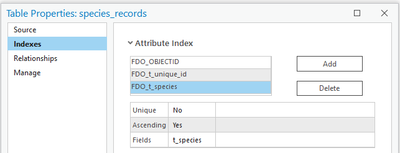

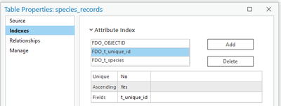

Some of the fields have asterisks (*) beside the field names, indicating the field has an index.
I don't think I added those indexes intentionally. But maybe it happened when using a GP tool. I don't know if that helps these views work better or not. But it's something to keep in mind.
An observation:
Sometimes, SQL table aliases behave strangely in FGDB views. For example,  SPECIES_RECORDS S  and  S.* . Field headers in the attribute table will occasionally show a  S.  prefix. Other times it won't show a prefix. Sometimes joined SQL fields with duplicate field names will show up in the attribute table, other times not. I don't know what the reasoning is behind that, but it tells me aliases and field names are buggy. If I'm having trouble creating a FGDB database view, then I'll fiddle with the aliases in the SQL. I'll change  SELECT S.*  to just  SELECT *  . Or something like that.
Maybe it helps, maybe it doesn't.

I manually added the T_UNIQUE_ID field to the table after-the-fact. I think I just populated it using the field calculator by taking the OBJECTID and adding 99 (so that the first ID starts at 100). But you could use anything, including just copying the OBJECTID.
I honestly don't remember why I added the T_UNIQUE_ID field in the first place.
But, to my surprise, it seems to be necessary in order for the query to work in file geodatabases. If I were to replace the references to T_UNIQUE_ID in the query with OBJECTID, then the query would produce incorrect results. I'm not sure why that's happening since OBJECTID has unique values, similar to T_UNIQUE_ID. Both fields ought to be able to serve the same purpose in this scenario. To prove that point, using OBJECTID works fine in a mobile or enterprise (Oracle) geodatabase. It's just the file geodatabase that's returning the wrong rows.
So, I guess you'd need to use a unique ID column other than OBJECTID to make the query work. Having a unique ID column in a table other than OBJECTID is a good data management practice anyway, so maybe it's worth it.
