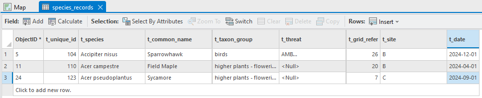

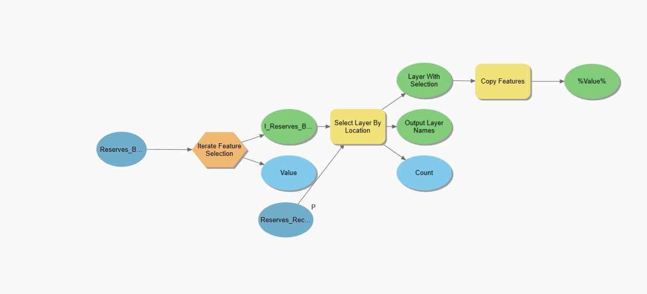

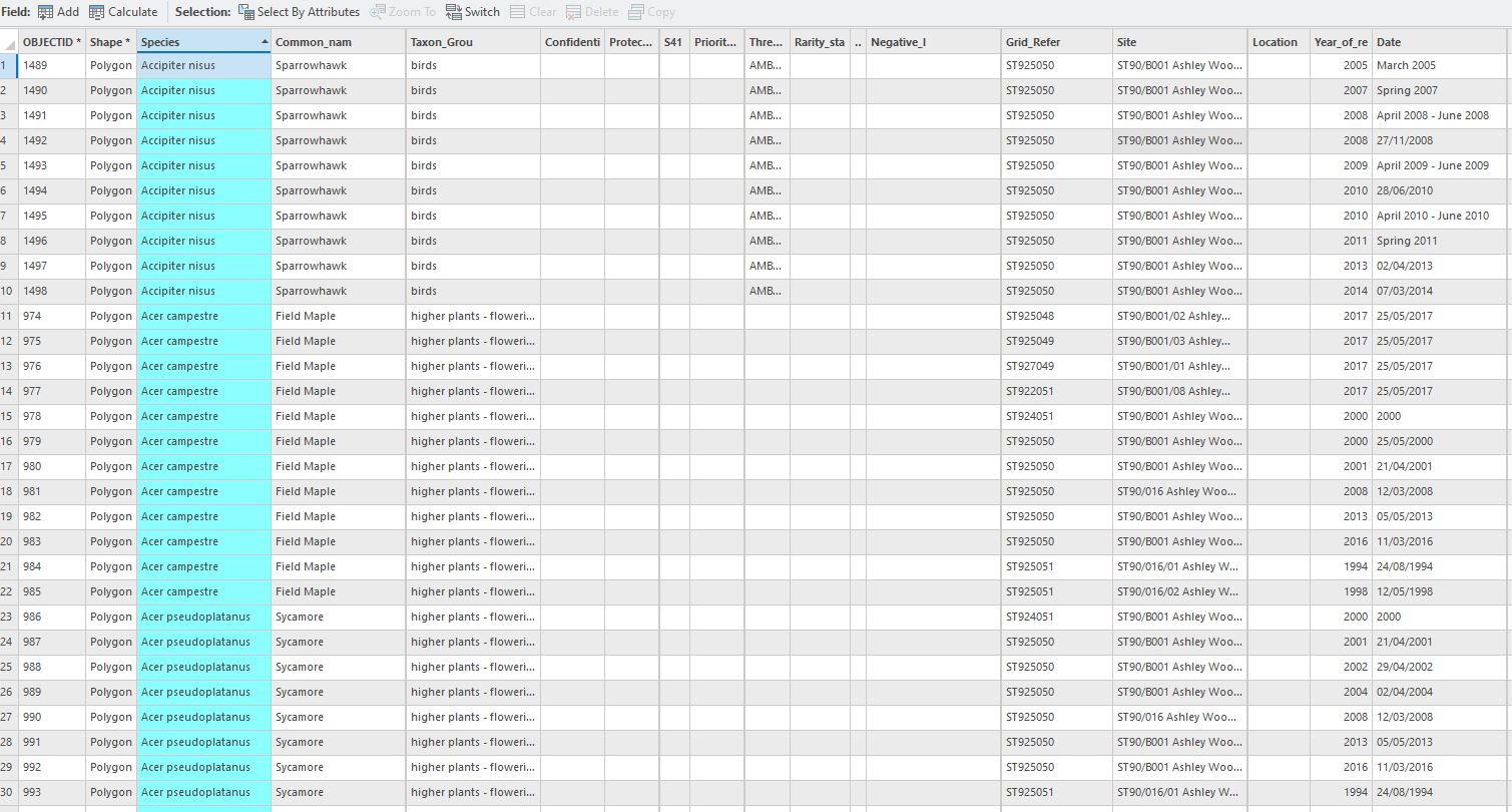

Hi,

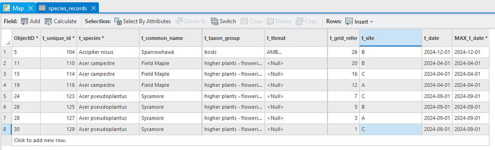

I have built the model in the picture, which works fine. But the next step I want to do is for each of the new feature classes that are created, I want only the most recent record of each unique record from the species field. But I want all the associated fields to come through into the new feature class. See table picture below, for example I only want the most recent record of Sparrowhawk.
I am not sure how to do this and if I can add it into the model as part of the process?
Thanks

Thanks @DavidPike and @RichardHowe for the collect value suggestions. How do I run the select by attributes tool, to select for max year or rec before collecting the values? I cant add a workspace as an input. If I was to collect the values and then run it, all I'd be doing is splitting and recombine the dataset. Maybe i need to go back to the original dataset before splitting them out into the individual sites?
Sorry this is bit painful! Feel free not to respond!
Thanks
RichardHowe
We already established that query wouldn't work  on the initial dataset because you can't subquery the group. The split is important first so that then you can ask it for the newest value within each group.
If colect values isn't allowed as an input the "create feature layer" (a quick look suggest it might not be) then I go back to my original suggestion. Save what you have, create a brand new blank model and then drag and drop your saved model from catalog into the new model and iterate over the output gdb for each feature class and make those the inputs for the "create feature layer"
SteveMasters
Still trying in model builder. The above I tried with just one of the feature classes I need iterate through to get to my result. So this will go through the input feature class and split by attribute on 'species', works they all end up in the output geodatabase as separate feature classes. But then I need to iterate through these using the select by attribute to get the max year of record. But it fails at this point as the output of iterator won't go in. It says 'table not found'.
RichardHowe
You will have to create a layer from the feature classes ("create feature layer" GP tool) then use the select by attribute on that
DavidPike
MVP Notable Contributor
Yeh I had a look at this and you'll need to go with Richard's suggestion of a submodel as you can't have 2 iterators.  The collect values wont work so you need to have an iterator to go over the feature classes in that workspace (output from split by attributes).  The iterator would run that select by attributes query for each feature class (which Richard supplied earlier) -> Export to new feature classes -> Collect values -> Merge.
This kinda stuff is where you'd really want Python instead.

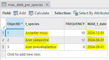

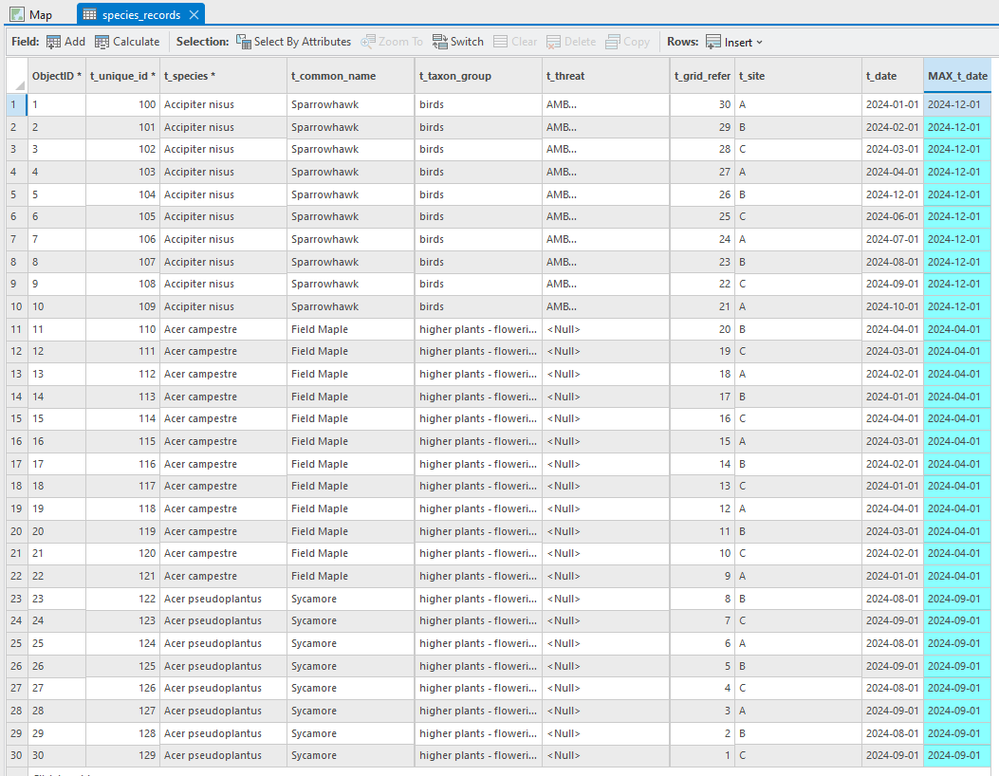

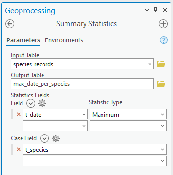

Here's a way to do it using Summary Statistics, joins, and a definition query. It has more steps than I'd like. And it outputs and utilizes static tables. But it does seem to work.
Steps:
Create a Summary Statistic table that groups the rows by species and includes a max date field.

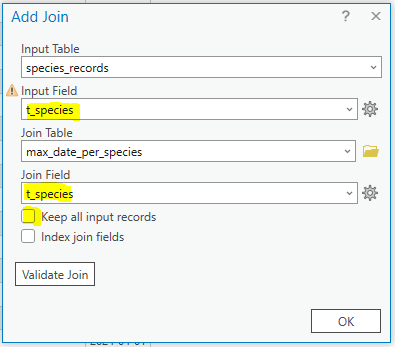

Join from SPECIES_RECORDS to MAX_DATE_PER_SPECIES where T_SPECIES=T_SPECIES. Uncheck the "Keep all input records" option.
Hide all the join fields except MAX_t_date.
Create a definition query on SPECIES_RECORDS.
species_records.t_date = max_date_per_species.MAX_t_date
That gives us the latest rows per species.
But there are multiple rows with the same date per species. If that's ok, then we can stop here. But if we want to break the ties, then we can do some more steps.

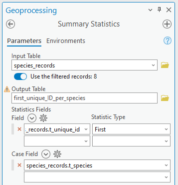

Use the SPECIES_RECORDS table (which still has a join and a definition query) in Summary Statistics.

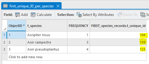

I chose to use the first unique ID per species. But I could have chosen the last. It doesn't matter, since it's arbitrary. When there are multiple rows per species with the same date, we choose an arbitrary row to break the tie. We don't have a PRIORITY field, or something like that, that we can use further refine the tie breaking.

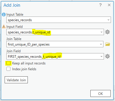

Join from SPECIES_RECORDS to FIRST_UNIQUE_ID_PER_SPECIES where T_UNIQUE_ID = T_UNIQUE_ID. Uncheck the "Keep all input records" option.
Hide all the joined fields.
Now we have the latest row per species, and ties are excluded (arbitrarily).
