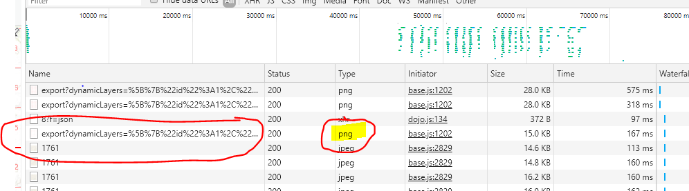

How do I get my layer to run as fast as the map server. I can see that its a png file that uses in ArcGIS Online.
Does this mean the data is in a raster format?
