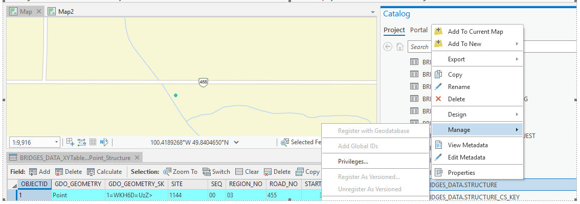

I have an existing Oracle database which has spatial information connected to Intergraph Geo Media. Now my company wants to move to ArcGIS Pro and I need to connect ArcGIS Pro to the same existing Oracle database.
I am able to connect and utilize the spatial information. My question is how do I edit the spatial content in the table in an existing database??
As far as I know, create a query layer and connect to existing database and also register the existing Oracle database to start editing the content in the table. but when I right click on a table and go to Manage. "Register with Geodatabase" is disabled. Can some one please help me on how to edit the content in an existing Oracle database??

Do you have "Geodatabase" or just a database?
Do you have ArcGIS metadata tables (GDB_ITEMS etc.)
You must have these tables if you want to register into geodatabase.
Use Create Enterprise geodatabase GP tool.

No it is just a database which has spatial information used for GeoMedia.   When I create using Enterprise geodatabase GP Tool is it going to create a new database??  How will this existing database become Enterprise Geo database??

When you run the Create Enterprise Geodatabase tool it will create a new schema (SDE) in the Oracle database and the required tables/procedure/triggers/etc. in that schema to enable the geodatabase functionality.
More details:
https://desktop.arcgis.com/en/arcmap/latest/manage-data/gdbs-in-oracle/overview-geodatabases-oracle....
https://desktop.arcgis.com/en/arcmap/latest/manage-data/gdbs-in-oracle/setup-geodatabase-oracle.htm
