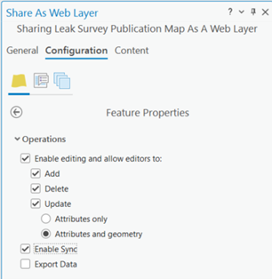

The “Publish the Data” step is typically accomplished with the desktop tool, ArcGIS Pro. The “Share as Web Layer” tool is the specific tool to use to publish the feature service.
By default, a feature service does not support synchronization. To activate synchronization, check the box “Enable Sync” within the feature properties configuration panel.

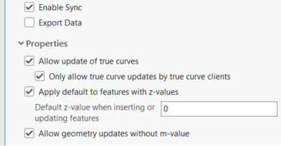

Share as Layer Pro Form.pngMany of the featureclasses in enterprise geodatabases have their geometries configured to support the storage of elevation (Z) and distance along a line (M). Field editors of this Z-enabled and M-enabled data may not have this information available at the time of data capture. To allow field editors to collect this information without a complete geometry definition, default values and behavior need to be defined.
For the Z value check the box to turn on the “Apply default to features with Z-values”. Then set the default z-value to the desired value.
For the M value check the box to turn on the “Allow geometry updates without m-value”. This will set the M value to NULL when a new feature is created.

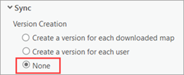

Version Creation = None
If the answer to this question is that mobile workers will only view and query the utility network data, then the default setting of “None” is the correct setting. With this configuration no additional versions are created or required to successfully sync.
If you set the Version Creation option to “None” and allow your mobile workers to edit the utility assets, those edits will be posted directly to the default version. Syncing to the default version will share these edits immediately to all other office and field users.

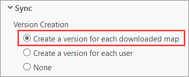

Version Creation = Version for each downloaded map
This option is recommended when your mobile workers are editing the utility network managed utility assets, and those edits need to be reviewed and quality control checked prior to sharing with the rest of the organization.
When this option is chosen, a branch version is created within the enterprise geodatabase when the mobile worker downloads the offline map area for the first time. All field edits will be synchronized to the created branch version.

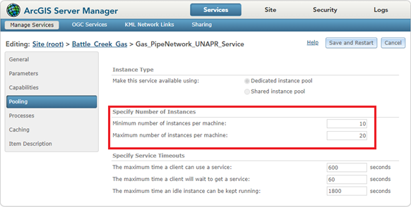

At the beginning of each workday there will likely be a spike in the number of mobile devices attempting to sync to the published feature services. This spike is caused by the mobile workers opening Field Maps and the offline map area enabled web map on their mobile device. This will initiate a synchronization.
The capacity of a single feature service to scale to accommodate this morning spike in concurrent devices requesting to sync is defined within the pooling portion of a feature service’s properties. The pooling parameters which directly impact capacity are: Minimum number of instances per machine” and “Maximum number of instances per machine”. These parameters are adjustable after the feature service is published.
The Minimum number of instances per machine value represents the base level of concurrent users that a single server can support.  As the number of requests for data increases the server will automatically start creating new additional instances.  This will continue until either the concurrent demand for data is met or the Maximum number of instances per machine is reached.
If the number of concurrent user requests exceeds the maximum number of instances value, additional users will be put into a queue and must wait for an instance to become available.
After the morning spike in synchronization, the number of concurrent users requesting data from the feature service will decline.  This will cause the number of instantiated instances to decline until the minimum number of instances per machine value is reached.

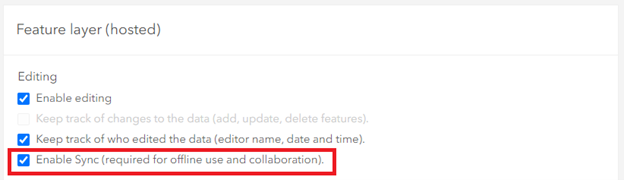

Hosted Feature layers provide another method of publishing data for synchronization to mobile devices. The publication process is integrated into the Hosted Feature layer initial creation process. Once a Hosted Feature layer is created it is automatically published as a feature service.
Similar to an Enterprise published feature service, a hosted feature service is not sync enabled when it is initially created. Enabling sync is a task for the hosted feature layer owner, modifying the settings.
Checking the box to Enable Sync is all that is required to enable syncing.

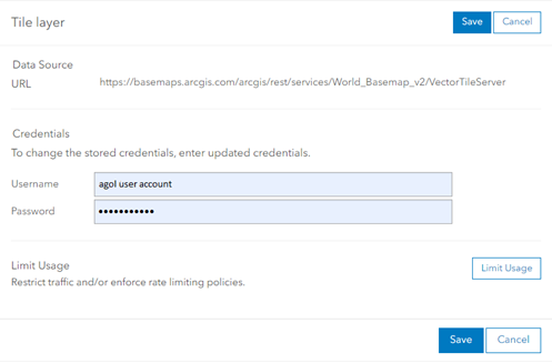

The final data source to prepare for offline map areas is the basemap. For our example we will use an Esri curated basemap. Most of the Esri provided basemaps are not compatible with offline map area syncing. All ArcGIS Enterprise referenced default basemaps are NOT valid for offline map areas. Only a subset of the ArcGIS Online basemaps is valid for use within offline map areas. A listing of the 19 Esri vector basemaps for offline map areas (for export) can be viewed here.
Using these ArcGIS Online basemaps in ArcGIS Enterprise requires that the basemap be registered as a layer in Enterprise, and that a valid ArcGIS Online user account is embedded within the registered vector tile layer.
It is recommended that this ArcGIS Online user account is not an employee’s active account, nor should it be an account with administrative rights. This embedded user account should be a non-user account created expressly for access to the basemaps.
