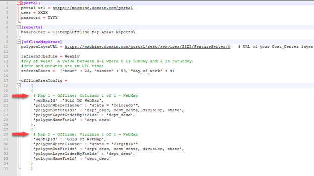

The programmatic approach uses a Python script to automate the creation of offline map areas.   Attached to this blog is a script that creates offline map areas using a polygon feature’s geometry.  The script uses a configuration file that contains your ArcGIS Enterprise credentials, the URL of your polygon layer of operating areas, Web Map IDs and the instructions for creating the offline map areas.

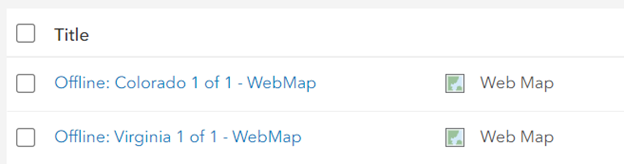

In this sample configuration file, there are 2 web maps that are defined in the offlineAreaConfig section.

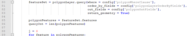

When the script runs, offline map areas will be created for the polygon features that satisfy the “polygonWhereClause”.  In both instances, both Virginia and Colorado had less than 16 polygons.  If these states contained more than 16 areas, the where clause would need to be redefined.

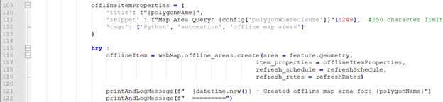

Knowing that every utilities’ data model will be slightly different, multiple entries in the configuration file are used.  This gives the script flexibility to name the offline map areas using the fields in your data along with allowing the script to run in your Dev, Test & Production environments without making code changes.

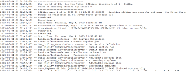

Another benefit of using the Python script is the log file.  This provides documentation as to when each offline map areas was created and the duration it took.

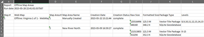

After setting up the configuration file and running the python script, 100 offline map areas in 13 web maps have been created.  A simple way to report on these offline map areas is now needed.  The log file has good information but wasn’t meant to be a report.  There is another attached python script that generates a CSV file containing details about web maps with offline map areas.  The CSV identifies the contents of each offline map area and the files sizes of every Vector Tile package and SQLite database.  Not only is this report useful for knowing what exists in your Portal but also show the amount of data to be downloaded to a mobile device.
