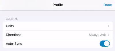

ArcGIS Field Maps provides the ability to automate this bi-directional synchronization. When auto-sync is turned on it will automatically initiate a sync when it detects a network connection to the enterprise environment.
This auto-sync will occur every 15 minutes if a persistent connection to the network is maintained. For the mobile user this provides a very simple daily workflow. On a typical day the mobile worker would start in the office. While in the office the mobile worker simply opens Field Maps and selects the web map offline map area they intend to use for the day. By opening the map while connected to the office network Field Maps will automatically initiate a sync.

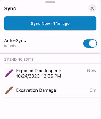

During the day the mobile worker can view, query, and edit against their local offline map area. All edits will be stored on the device.

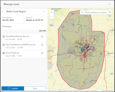

The first type of data structure change to consider is the addition or removal of a layer or table to the web map. For these changes, the Update tool within the Field Maps web application is the tool to use. The update tool is very simple to use, simply click on the Update button and the Portal hosted offline map area package will be updated.
When the Update tool is run it will initiate the updating of those mobile geodatabases within the Portal hosted offline map area package, which have had layers/tables added or removed. Additionally, the Update tool process will remove mobile geodatabases whose content is no longer referenced by the web map.

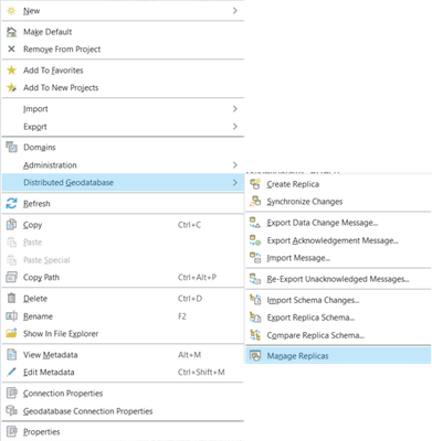

Administering a fleet of mobile devices and the data caches stored on them can involve situations not everyone thinks about during initial planning and user acceptance testing (UAT).  For example, how does an organization deactivate a mobile device from syncing when that device has been lost or stolen. Or how do you unregister a mobile device’s offline map area when the device breaks?
A different set of administration tools is needed to manage these types of situations. To manage the offline map area registration data stored within the enterprise geodatabase we need ArcGIS Pro. ArcGIS Pro provides the tools to visualize and manage all the offline map areas (feature service replicas), registered to an enterprise geodatabase.
Accessing these Manage Replica tools is done via an administrative connection directly to the enterprise geodatabase.

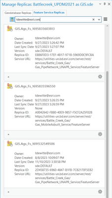

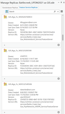

Within the Manage Replica tools is a tab for Feature Service Replicas.  This tab will present the list of all mobile device caches registered to the enterprise geodatabase.

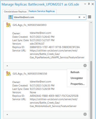

Searching by the username of the person whose device has failed or is lost, you can find the replicas to that mobile user.
From this listing you can select the feature service replica which needs to be removed and unregister.  Unregistering will remove its entries from the enterprise geodatabase and prevent synchronization.
