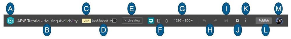

Builder Toolbar
At the top of the builder is the toolbar. The toolbar contains a lot of functionality relevant to the management, viewing and publishing of your experience.
ArcGIS Experience Builder ToolbarArcGIS Experience Builder ToolbarArcGIS Experience Builder Toolbar
  1. Home button – return to the ArcGIS Experience Builder Home Page.
  2. Name – change the name of the experience item.
  3. Status – currently three statuses of draft, published and unpublished changes. Only one status is ever present.
  4. Lock layout – lock the layout to avoid unexpectedly changing a widgets size or position.
  5. Live view – test widgets on an active page.
  6. Device mode – view the experience in different device modes (large, medium, and small) and create a custom layout.
  7. Change screen resolution based upon device mode.
  8. Undo/redo buttons – undo or redo your last actions.
  9. Save – saves the experience.
  10. Preview – view the experience to evaluate functionality from the experience’s starting Home Page.
  11. More – save as, delete the experience, change share settings, create new, generate template and more.
  12. Publish – publish the experience to an ArcGIS Online or ArcGIS Enterprise portal.
  13. The portal user information.

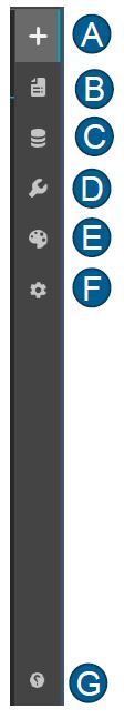

Sidebar
The sidebar is located on the left side of the builder and allows you to open the widget, page, data, utility, and theme panels to add new elements and edit the overall design. When you click on an item on the left sidebar, the left pane becomes active with those items for the task.
Left SidebarLeft SidebarLeft Sidebar
  1. Insert – inserts widgets onto your page. Types of widgets include map-centric, data-centric, page elements, menu and toolbar, layout, and section.
  2. Pages – top half of the UI it to manage pages and windows and the lower half shows the page outline.
  3. Data – the application framework. You can add web maps, web scenes, layers, and URL’s.
  4. Utilities – add user provided utility services to the experience.
  5. Theme – a preset style scheme for the appearance of your app
  6. Settings – general settings for your app (favicon, thumbnail, summary, time zone and URL status).
  7. Help – provides a link to Help documentation, showing a guided tour and what is new in ArcGIS Experience Builder.
