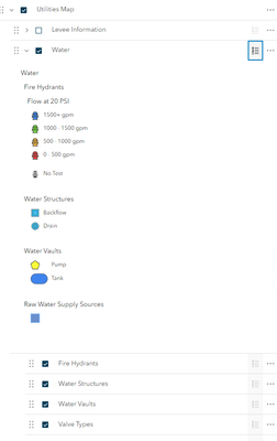

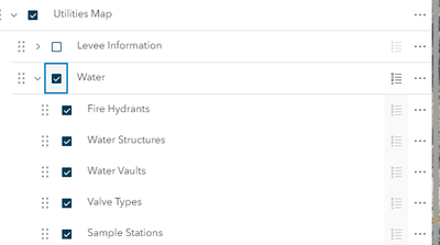

BUGS: I have run into a snag where the legend of layers nested in group layers 3 levels or lower is not displaying (they are visible at the range shown in all images below). The legend icon stays greyed out.
They are displayed in the legend of the group container at the top, however.

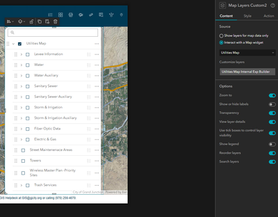

The other issue I am encountering is that the legends are staying on when checking the radio button to off for Show legend in the configuration settings.

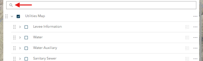

ENHANCEMENT: I would like to add hint text to the layers search that says "Filter Map Layers" and change the magnifying icon to a filter icon.
