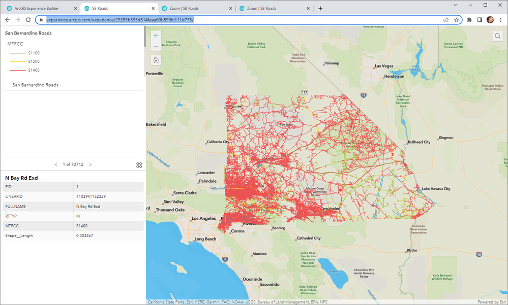

In my example – I have a basic web application showing the street network of San Bernardino County. The app works, but I also want the ability to send users to specific street segments when the app opens. So… how can I do it without the ‘zoom’ url parameter?
Here is the link to my app – feel free to play around with the parameters/URL as well: https://experience.arcgis.com/experience/29285b535d614faaa60b599fc111d775/

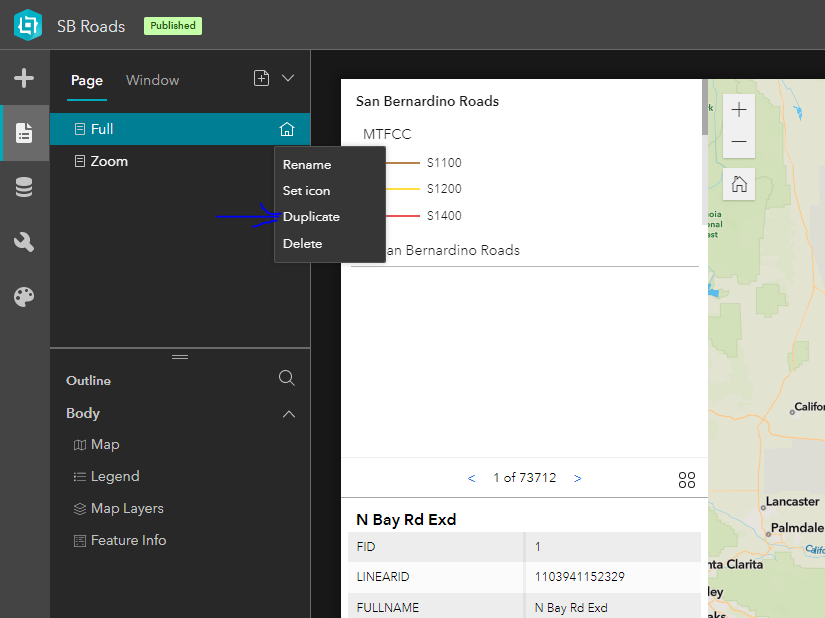

The first trick – is to use the ‘page’ functionality that is found in Experience Builder. After I have my application built out, I just duplicated it under the pages section.

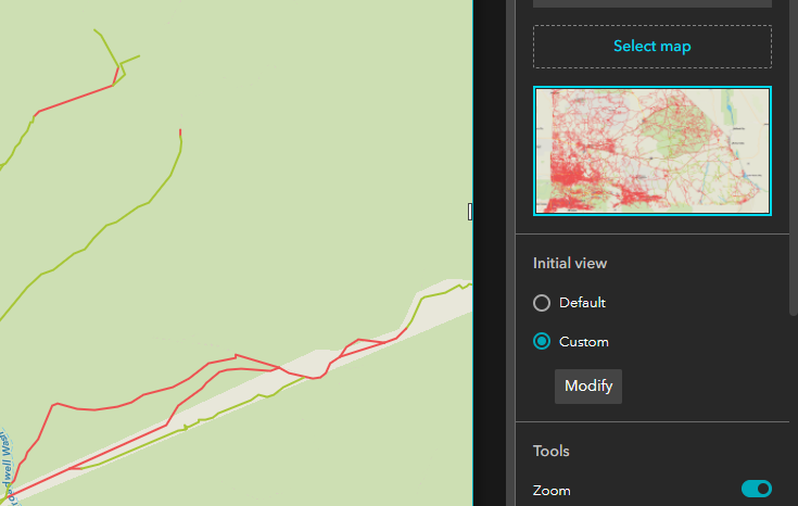

You can then rename your pages, which will be used in the URL. After you have your second page created, go to the settings for the map object and modify the initial view of the map. It doesn’t matter where you focus on, just what zoom scale you use.
After you have done this, you are basically done. You can save and publish your app.
