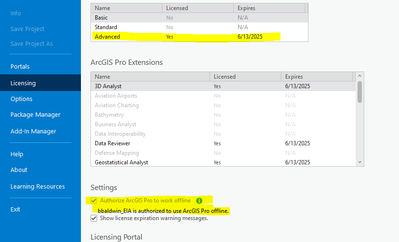

In the screenshot below – I have taken ArcGIS Pro offline. We can see that my Advanced license expires on 6/13/2025 and the username ‘bbaldwin_EIA’ is listed as the authorized user.
So – my user now has a license checked out on his/her machine – and they are good to go!
“What if I check out a license on 6/10/2025…?”
If the user above (with a license expiring on 6/13/2025) checks out a license on 6/10/2025 and heads into the field, the license of ArcGIS Pro will expire on 6/13/2025 and ArcGIS Pro will fail to open/work.
