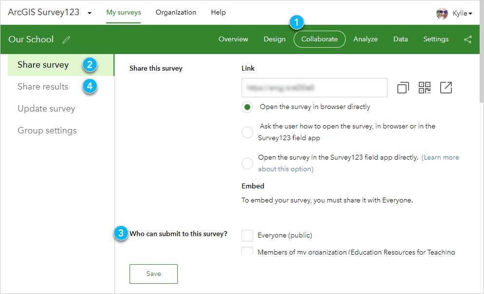

  1. Once your survey is designed and ready (other than your updated map), publish it and go to the Collaborate tab.
  2. In the Collaborate tab, update Share survey.
  3. Set Who can submit to this survey? to the students collecting the data (this can be a group, your org, or even publicly).
  4. Still in the Collaborate tab, go to Share results and set who can view results of this survey so that with the students doing the data collection also have access to the results. (This can also be a group, your org, or even publicly.)

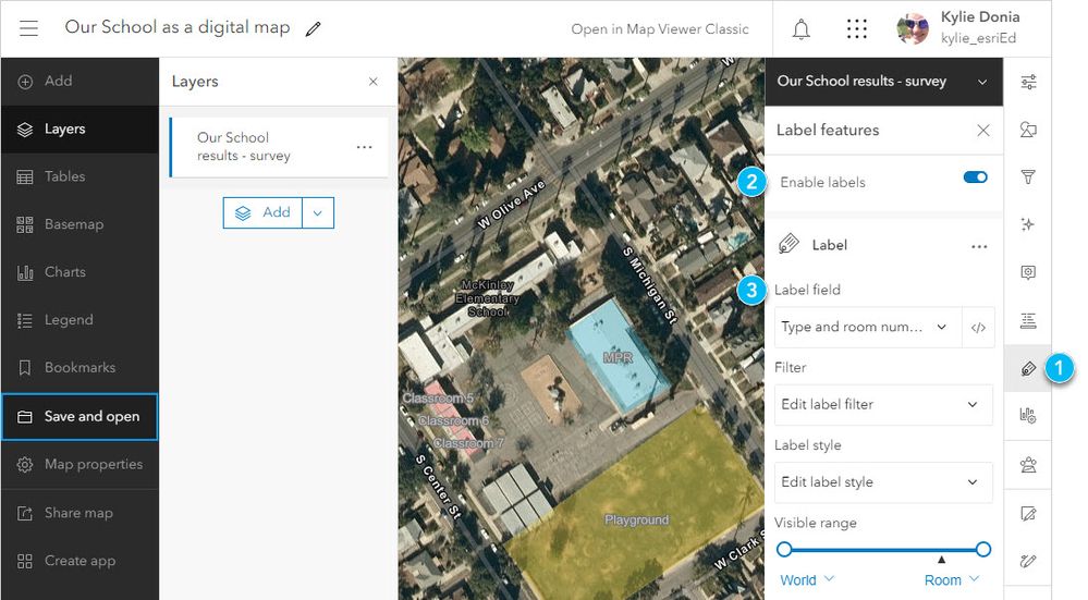

  3. Configure labels on the results layer as follows:
    1. On the light toolbar, click Labels
    2. Enable labels if they aren't already enabled.
    3. Click Add label class and for Label field choose the field in your data you'd like to see as the label on the map during collection. If you want, you can click </> and use an expression to show multiple fields.
      Since the items on the map won't be clickable, the label gives the data collector information about what's already captured.
  4. Save your map.

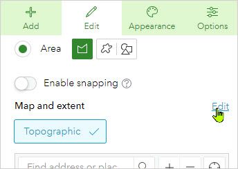

  3. Beside Map and extent, click Edit.

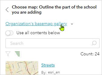

  4. At the top of the panel, click Organization's basemap gallery to change where you are looking for maps, and choose My content.

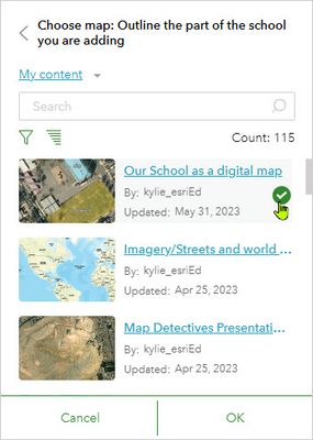

  5. Click the map you made in the previous step to select it, and click OK.

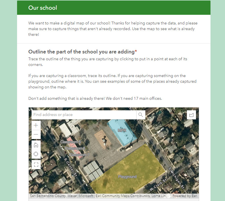

As students and other data collectors work, the map in the survey will show the items that have already been collected. Before they add something to the map, they can check that it's not already there.
