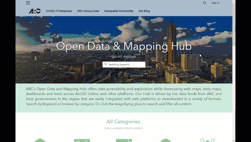

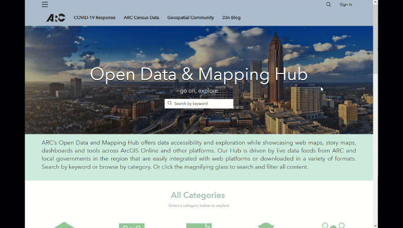

The Atlantic Regional Commission has a great open data site (that also consolidates regional open data sites, ex. John’s Creek). From this site, you can simply search for data, and then add the layers to a map and get started.
Just add the services to your map!

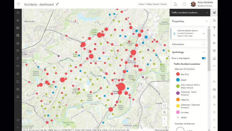

When you save the map, students now have their own ‘copy’ of a map that they can configure, which is connected to the source data set. As new features and records get added… their map will update.

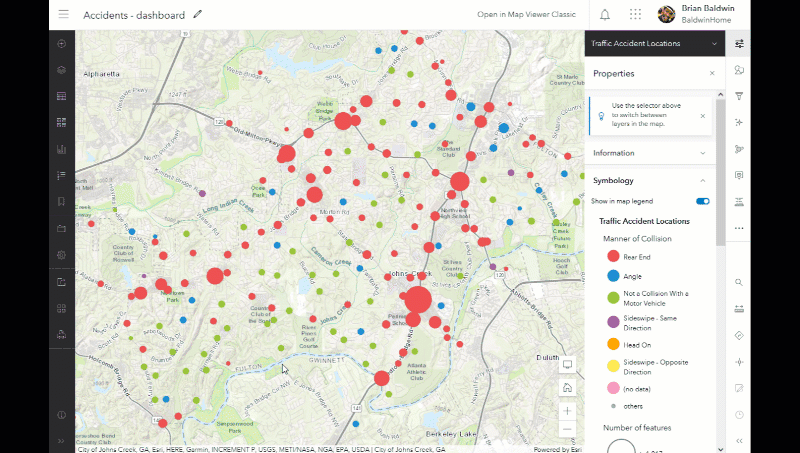

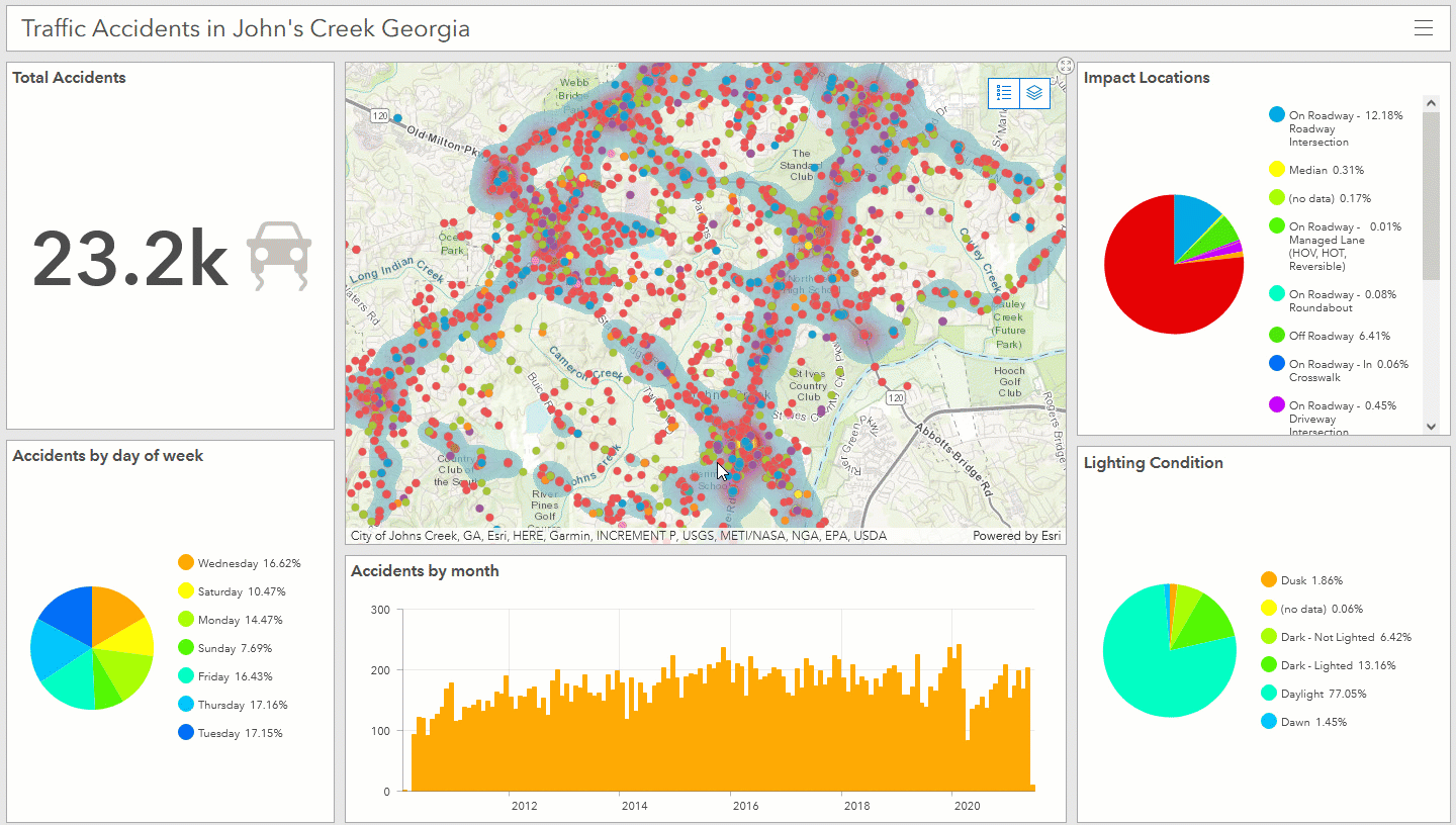

Directly from the Map Viewer, students can launch one of the ‘application builders’, which are configuration frameworks for sharing the map. The one that I focused on here is ArcGIS Dashboard, which I’ll configure with a summary stat, date/time bar chart, and a pie chart to show accidents by ‘lighting condition’.
Get that dashboard configured
