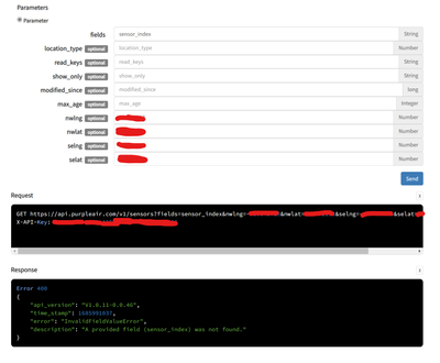

Edit: if I just use "name" then I get the sensor_index and the name, in the output.
Do you add sensor_index (for building the sensor group) under fields? I get an error: sensor_index was not found. I wonder if it because it's an integer, but the parameters request a String.
BrianBaldwin
@Teresa_Blader - So the 'fields' value is a string, but you need to then insert a comma seperated list of fields that you want returned - so instead of 'sensor_index' try adding something like:
name, icon, model, hardware, location_type, private, latitude, longitude, altitude, position_rating, led_brightness, firmware_version, firmware_upgrade, rssi, uptime, pa_latency
The bounding box information you are sending in the request should limit what gets returned to just the georgraphy you want.
