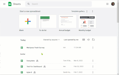

  1. Open Google Sheets and open your CSV. It might be one that you created, or one that you saved to your sheets.
