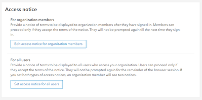

Lastly – you can also set an ‘access notice’ that will be presented to users when they log into ArcGIS Online or ArcGIS Pro (example included in the short GIF further down).
Here is a basic demonstration of what the experience will look like to users (as a note, I didn’t need to enter my SAML credentials because my most recent login was still cached):

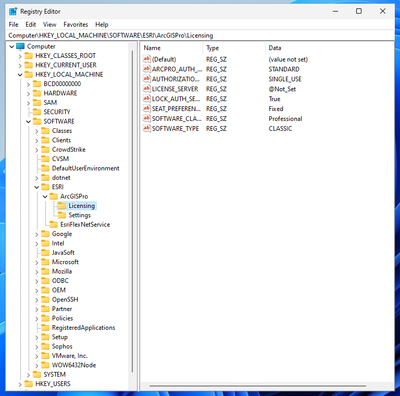

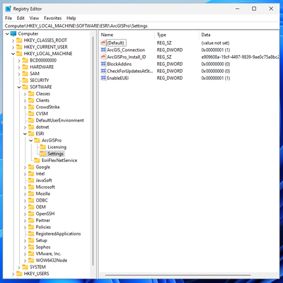

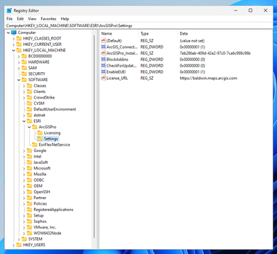

In the Windows Registry Editor, under HKEY_LOCAL_MACHINE, Software, Esri, ArcGIS Pro, you should find 2 keys (Licensing and Settings) that look similar to the ones below. These screenshots are from installation that used a single use license with the silent install.

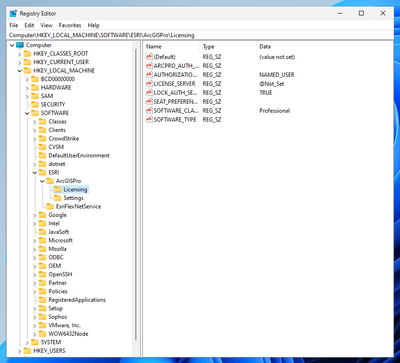

Under Licensing, the following changes need to be made:
  • AUTHORIZATION_TYPE from SINGLE_USE to NAMED_USER
  • SEAT_PREFERENCE - deleted value (Fixed)
  • SOFTWARE_TYPE - deleted value (CLASSIC)
Under Settings, the following changes need to be made:
After you make the changes, it should look like the following screenshots:

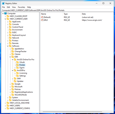

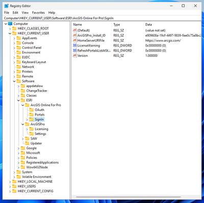

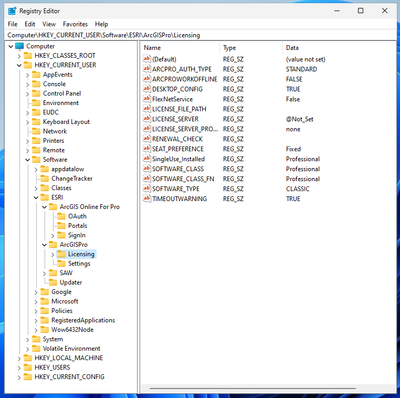

The following screenshots show the CURRENT_USER keys for ‘Portals’, ‘SignIn’, and ‘Licensing’ after the user opened ArcGIS Pro in a single-use license deployment.
Under Portals, the following changes need to be made:
Under SignIn, the following changes need to be made:
  • Update ‘SOFTWARE_TYPE’ to ArcGIS Pro
