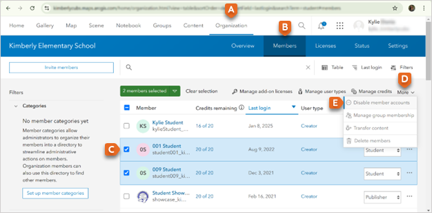

1. Disable the account
Once a user has left your school or district, disable their account to remove their access to it. You can disable a single account or multiple accounts.
  1. In ArcGIS Online, click Organization in the top bar.
  2. Click Members in the blue bar.
  3. Select the account or accounts to disable (up to 100).
  4. Click More above the table.
  5. Click Disable member accounts.
