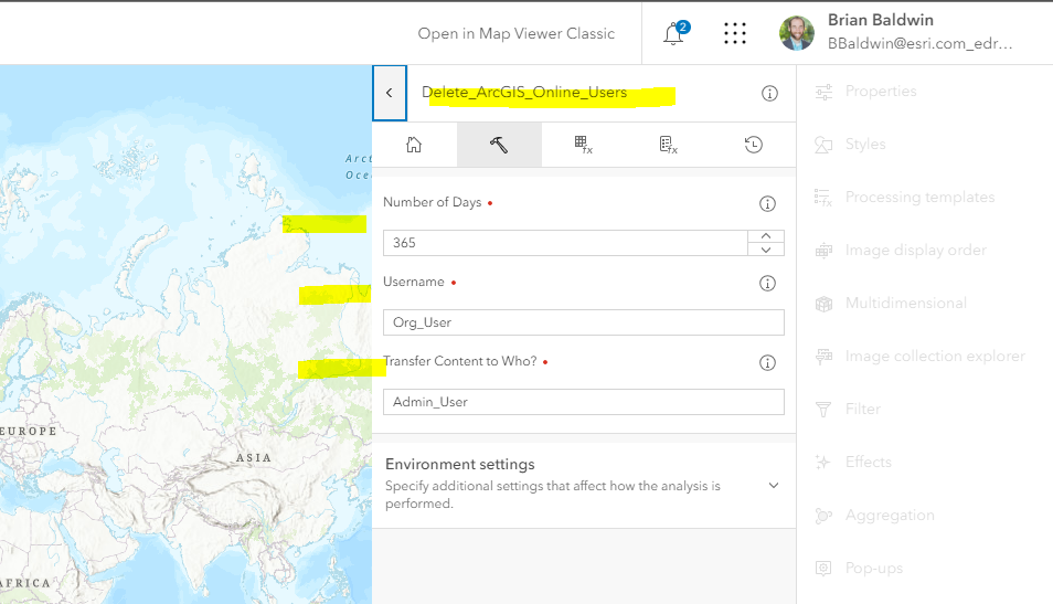

In the MapViewer - I now have a basic tool that let's me query for the 'Number of Days' since users have logged in, query for a specific user name, and also transfer their content over to someone else.

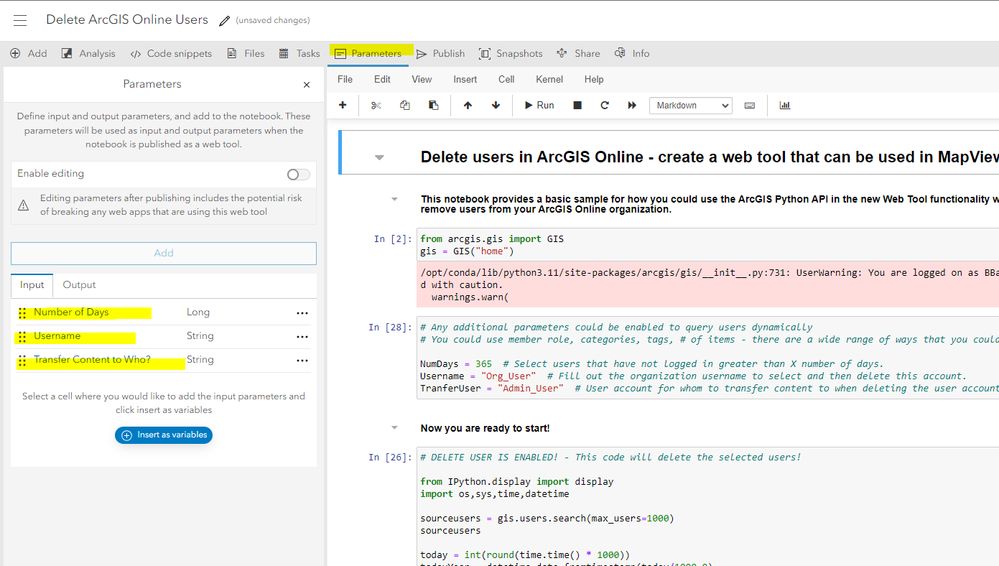

After I imported the script into the ArcGIS Notebook, I then created parameters:

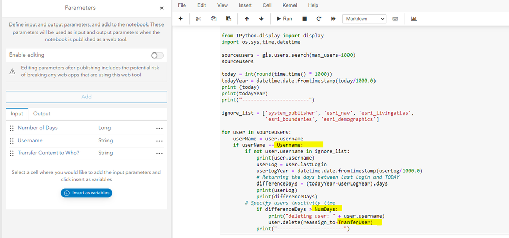

I then made sure to update my script with the variable values for the parameters that were created:

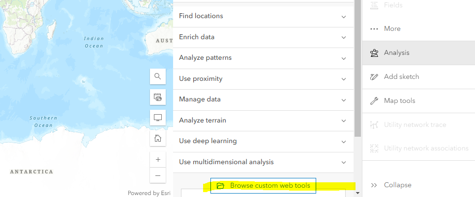

Within MapViewer - it's as simple as going to the Analysis pane, and then selecting the new 'Browse custom web tools' option:
The UI is then populated with the parameters and values from your custom web tool - and you are ready to run it!
