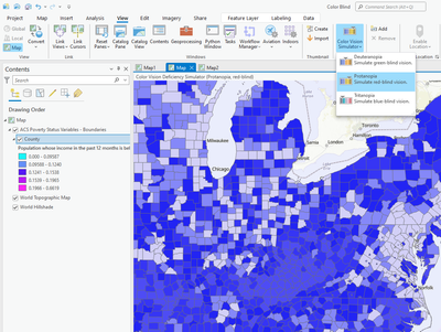

For example, here’s my first stab at creating a basic choropleth map showing poverty rates across the US. My color choices are interesting, but it works… right?
With ArcGIS Pro 3.0 – there is a new toolbar in the View ribbon, that lets you toggle between 3 different color blindness simulations: deuteranopia (green blindness), protanopia (red blindness), and tritanopia (blue blindness).
With just a simple toggle, I can test to see what my map looks like with the simulations. My map below shows the symbology with a protanopia simulation, and it highlights a really big issue with my symbology choice. With the red color family now removed… the contrast between the blue colors is really subtle.
Similarly, if I toggle the simulator to display the map for tritanopia (blue blindedness), this map works to some extent, but the middle range values stand out more than I would like them to.
In my example, I finally arrived on a BW map, which as every old-timer knows, is also going to work well when it’s printed, or photocopied. Or, you could introduce symbology concepts like textured fills that would work well for print or color blindedness.
