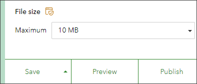

  • In Survey123 Connect or the browser, you can set the maximum file size (in MB) for each individual image question. This will only be used when collecting data in the browser.
In both cases, this only applies to photos taken through Survey123. Photos that were added from the device use their original file type, resolution, and quality.
Learn more about restricting the image sizes in Survey123 Connect in Media questions > Images. In the browser, you'll find the File size > Maximum setting at the bottom of the Validation section for configuring an Image question.

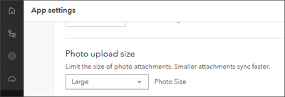

In ArcGIS Field Maps, there are a couple of ways to set the photo size:
  • The map author can set it as a part of the App settings specified during map configuration. See Configure the map > Specify photo size.
  • The data collector can set it in the mobile app's settings. See Configure the mobile app > Specify photo size. (If the map author has provided a size, the mobile app defaults to it when the map is open. Details for how to override the map author's setting and use a device setting instead are included in that linked topic.)
In both cases, the size is applied not only to photos taken through the app but is also used as the max size if uploading a photo to a feature.

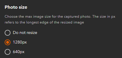

ArcGIS QuickCapture
In ArcGIS QuickCapture, you can set the photo size for all photos captured through the project. While configuring the project, go to the General settings and set the Photo size
