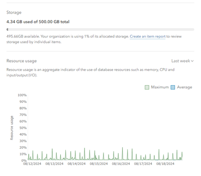

In the screenshot below, a user can quickly see how much storage is currently used.
By selecting ‘Feature Data Store’, users can also get a more detailed snapshot of resource usage by time of day, day of week.

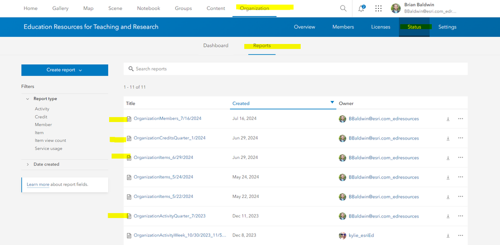

This selection brings up to the report page, which can also be navigated to by going to Organization, Status, and Reports.

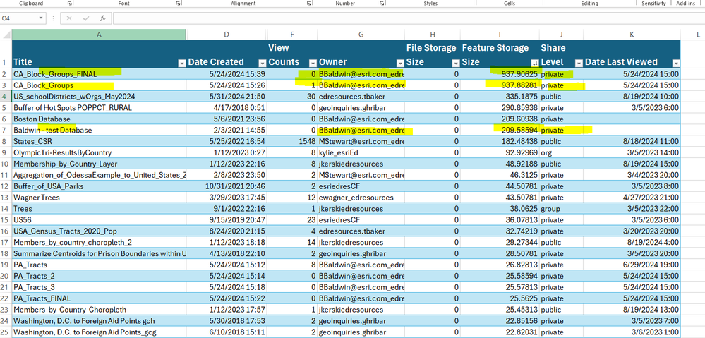

From within this page – users have the ability to build out an array of different reports that are then saved into the ArcGIS Online organization. For our purposes, we want to generate an Item Report. After the report is generated, it can then be downloaded as a CSV and should look something like this (I removed a few unnecessary fields and formatted the CSV as a table).

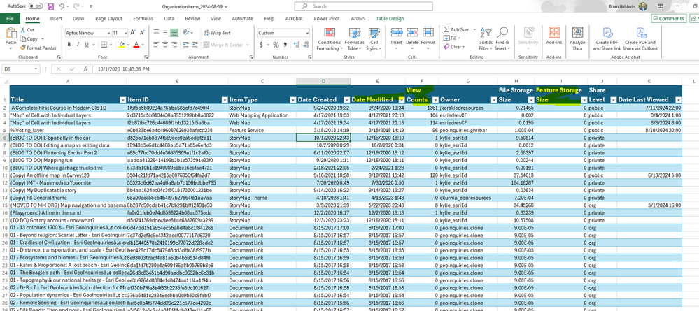

The fields that we care the most about are: Feature Storage Size (listed in MB), View Counts (is this item being used/viewed at all?), Share Level (Who is this shared with? Who is potentially using it?), Owner (username of the items owner), and Title
After sorting the data by the Feature Storage Size column, we already have some great information.
For this exercise - we don't care about the 'File Storage' column, so make sure you are looking at the right one. 'File Storage' plays no impact of your Feature Data Store, because it stores data in a different way/location (imagery, GDBs, etc). File storage will consume your organizations credits, but at a much slower rate than feature storage. To learn more about WHAT the differences are between the storage types, please read this documentation: Understand credits.
Right away, I can see that the 2 largest files in the organization (which are both nearly 1 GB in size) are duplicates of each other (same file name with the exception of ‘FINAL’). We can also see that the vast majority of the larger files in the organization are set to ‘private’, meaning that they aren’t being used by anyone but the owner. Also, looking at the view count for the files, I can see that some of them have views at ‘0’ and many are <10. Lastly, the owner information is listed along with the items. If you are unfamiliar with the username, you can use this to search across your members in ArcGIS Online and then drill down into the members settings to find their e-mail address.
