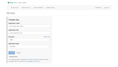

1) Get a Bing basemaps key
You can go to this Microsoft link and sign up for a free developer account to get access to a Bing maps key: https://www.microsoft.com/en-us/maps/licensing
There are also (quite generous) accounts for education usage.

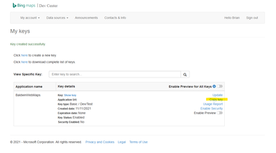

After getting an account, start by creating a new key:
 Copy the key:

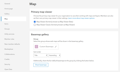

2) Create Custom Basemap Group
In ArcGIS Online, if you haven't already, you need to create a custom group to house your custom basemaps. Create a new group and call it 'Custom Basemaps', or 'Maps of the Base', or anything.
Then, under your organizational settings, under the 'map' section, select your new group as the location of your custom basemaps and then click the 'Share Basemaps' button as well.

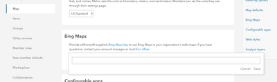

3) Enter your Bing key in ArcGIS Online
Under your organizational settings, in the map section. There is a space to enter your Bing maps key. Enter the key and hit save.

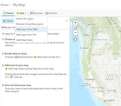

To create your Bing basemap, you will need to use the Classic Map Viewer.

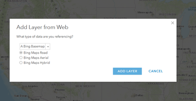

Launch the Classic Map Viewer, and choose 'Add Layer from Web' 
At the bottom of the dropdown list, choose 'Bing Basemap' and select the type of basemap you want to use.

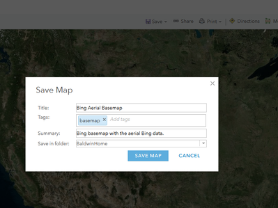

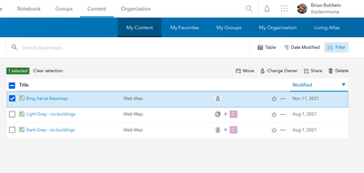

Now, you need to save your map.
After saving the map, share it with the new basemap group you created and share it with the organization (or keep it all to yourself).

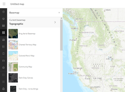

Now, when any user goes to add a basemap in ArcGIS Pro or the Map Viewers, they will have the new Bing basemap as an option.
