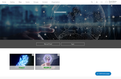

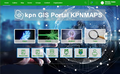

@BrianBaldwin. One more question.
I know there will be a new portal editor soon, but untill then we will use my new created page:
One thing I still want to change is to provide a tooltip when you hoover over the apps.
I would like to show a small description about the app, can you help me with that ?
