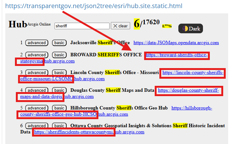

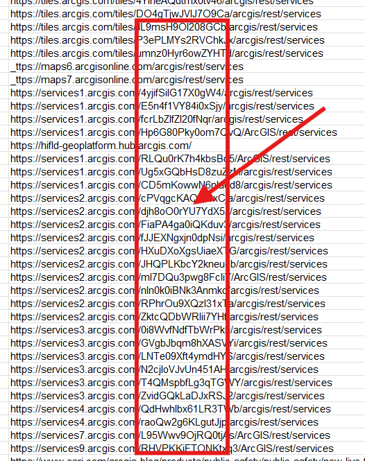

These mix of letter and number long string is arcgis online organization ID.
These ID does not tell you who is owner, if you can find the organization short name behind these ID, then you know the owner.  These red part are organization short name.
This is structure of Arcgis REST api endpoint.
https://services1.arcgis.com/[Organization ID]/arcgis/rest/services/[Feature Service Name]/FeatureSe...
As you can see, organization ID placed right after arcgis.com.
ESRI must have database to link the org id with org name.  The question is how we as public user can access this information?

I think ESRI does not provide a public database linking organization IDs to organization names. However, you can determine the owner by checking the organization short name in the URL, as shown in the red-highlighted parts. Some organizations also publicly have their details in ArcGIS Hub or Open Data portals. If ESRI has an API or tool for this lookup then it is likely restricted to authorized users. You may need to contact direct ESRI support for more information.
