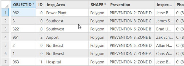

I saw a post similar to this about using the decode expression to populate a popup on AGOL. I have a little twist. I want the decode expression to select a different record depending on the value of a certain attribute and then return that record's attribute values.
So what I want to get is a line in the popup that says Secondary Contact and fills in the inspector name and phone number by the Decode determining which ID or OBJECTID record to use from the INSP_AREA of the polygon selected.
Within the record being selected by the ID or OBJECTID field to return the Inspector Name and Phone Number.
I'm a bit of a novice so not sure what I'm doing wrong.

Thanks for your help Ken. I learned a few things just from your reply but I'm still having a problem with the output. Here's everything again as I have it in there. The Error says Object not found $layer. I did not call out $layer as a variable because from what I've been looking at that should be known.
Just so you know I am doing this in ArcPro 2.9.6 as a label to test it before I put it into a webmap as a popup.
