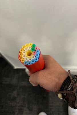

We have been connecting and associating fibre cable to individual microducts manually. Currently, there is no easier way to do this and even QA the connectivity. Tracing of duct connectivity does not even work 😞
I have seen many demos of Fibre Cable management tools but not an actual working management tool for Air Blown Technology. I know it's just a nested structure of conduits (similar to water pipes) at a smaller scale, but still, no one has one working for ESRI products - yet, or that I know of. The microducts are 7/3.5mm in size, and currently, these are non-spatial data, which makes it tricky to cut and manage. I met Schneider last year and have seen what their ArcFM / Fibre Capabilites are, but unfortunately, no development for ABF technology yet.

No worries. And thanks for replying. Yes, we have modelled it similarly to a cable. But since we have not invested in any fibre cable tool (unless the same tool can be developed to handle ABF), it's hard to say. Our current issue is management:
1. Connecting Tubes efficiently
2. Tracing the microduct route
3. Associate a cable is easy if only a single joint in between. In some feeder routes, there may be multiple duct joints in between, and since these are tiny tubes and some colors are the same, they sometimes end up with swapped connections.
4. Capacity Management
5. QA
