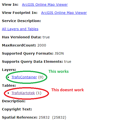

I got a FeatureServer with 1 layer and 1 table.
Im trying to create a popup on a webmap, the popup should display some data from the table, but the result is not as i expected. To figure out the issue, im using the following code

Can you confirm that "Parcels_And_buildings_3838" is a table?
The feature service I'm using consists of a layer and a table. If I query the layer using the same arcade script it works fine.

leonoestergaard
Hi Xander Bakker
We tried to removed all attributes from the table except objectid and globalid, the it worked, after re-adding the attributes it stil works. So the service might have been in some undefineable state
