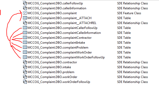

Hello Everyone,
I have a point feature with a single field used as the the attribute key for relationship classes to other tables.  I am looking to automatically create a row into the related tables with the key field populated from the point creation.  Any ideas how to auto populate the tables with that key?
Below is a screenshot of the inside of database.
Thank you!
Paul McBride

PaulMcBride
Thank for the reply.
Yes that is what I would like to do.
When a user places a new point I would like them to be able to edit the related tables immediately without having to create a new record for that point.  The related tables would automatically receive the point ID field that relates them together.
Thanks again.
