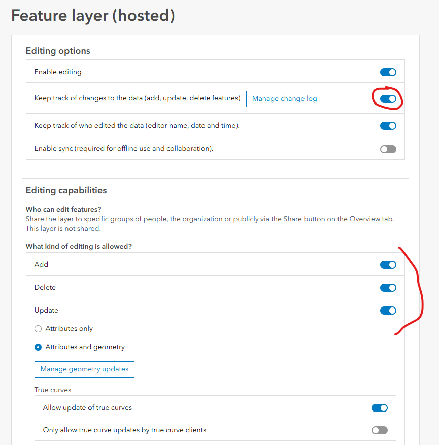

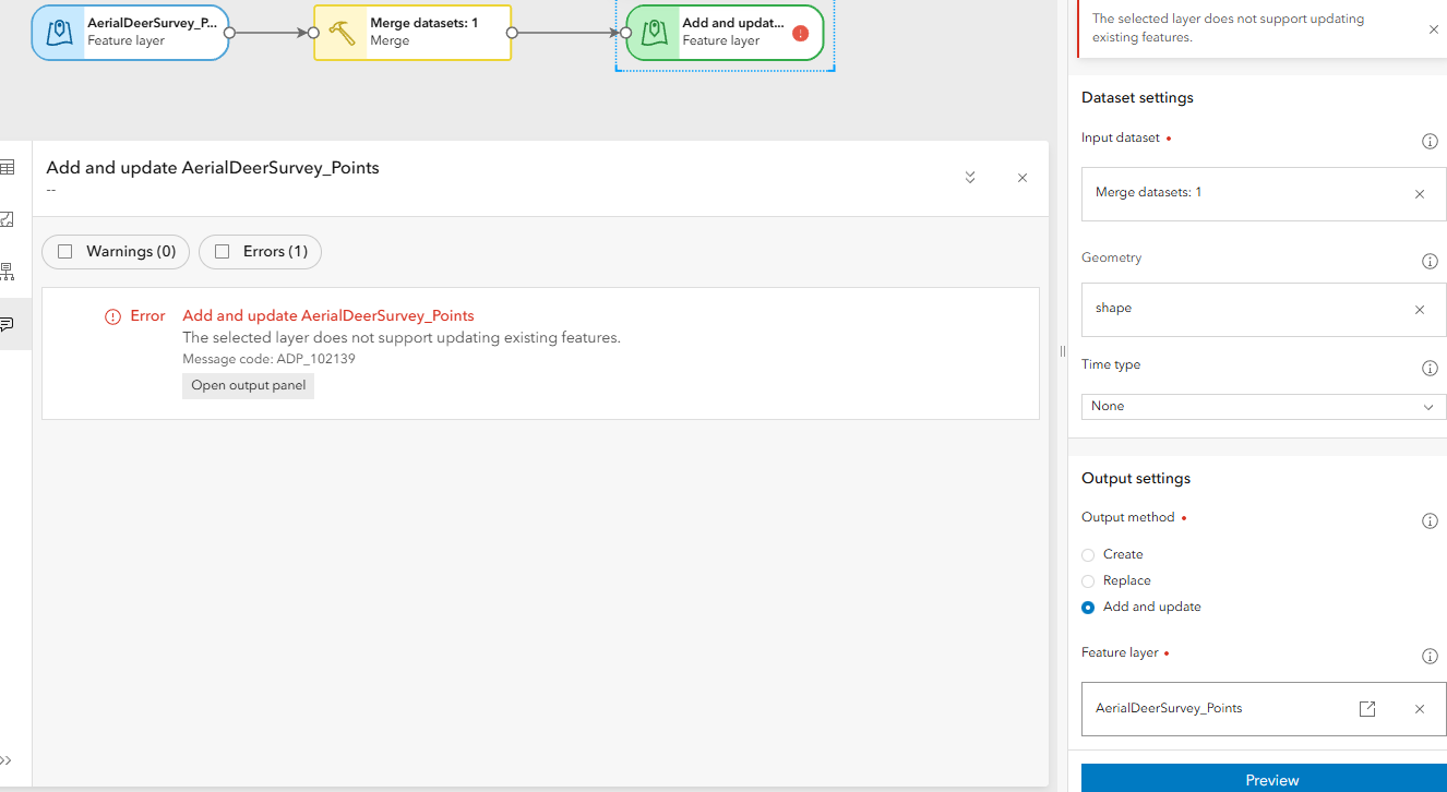

When enabling Editor Tracking on my output layer, the Pipeline throws this error:
Message code: ADP_102139
If I turn off editor tracking, the data previews with no issues/errors.
I was unable to find anything about this in the documentation. Is this a bug or by design?

Hi @Amanda__Huber,
Correct, a layer with editor tracking enabled can't be appended to when specifying a uniquely identifying field. It looks like we missed that limitation in our documentation. I'll make a note to add it.
Sorry for the confusion, and thank you for reporting this!
