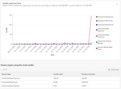

tmichael_wpjwa
I agree, I think it would be good to have more visibility into the history for Data Pipelines.  Metrics for last run time, duration, result (success, failure), and some logging possibly.
This is a timely topic because something happened yesterday with a Pipeline that apparently caused it to run way longer than it should have, but I have no way to know which one or why.  And for this specific example it would be nice to know the actual credit charge per pipeline / per run.
