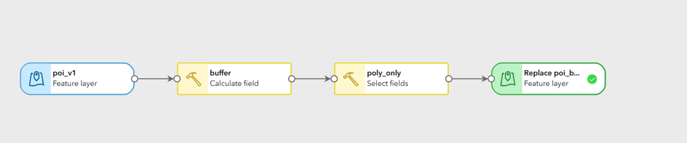

I would like to create a pipeline that automatically checks for new points created in one point layer daily and creates a circular buffer at a defined distance around each of those points in a new layer. I have tried to the "create geometry" tool, which does have polygon listed as an option under "geometry type" but am lost on what type of "geometry format" to use and what should be contained in the "geometry field" of the point layer. All points will be buffered to the same distance so that field can be a default value in the point field when the point is created.

Thank you for the response Venkat! I constructed the calculate field tool to create a polygon and inserted the arcade code for a 200 meter buffer. I used it on a point layer I created for this that contains two points. The tool does seem to run and complete, outputting two features. However, those features do not have anything contained in the fields and the buffers do not show up around the points on the map. When I add the layer it takes me to 0,0 because neither point contains any information. I also tried @rob_hewy's suggestion and had it only select the polygon shape field, I ran the tool before and after this and got the same result. I also tried "use default geometry" and "choose coordinate system" both with the same results. Screen shots below. @rob_hewy do you have any suggestions, seems like you may have been successful in getting this to work! Thanks in advanced!

Hi @BethanyScott, I gave this a try and it worked at generating the circular buffer which is fantastic! However, When I measured the distance of the buffer it came out to 148 meters, not the 200 meters that I had programed. I checked and changed the spatial reference but that did not solve the problem. Not sure what the problem is, I believe I changed the spatial reference to the correct coordinate system. I opened the layer in Pro and checked the spatial reference there before changing it in pipelines. Any ideas?

rob_hewy
Hi,
Not sure if it matters but I added a select fields to remove the original shape field that had the point
