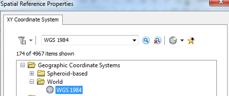

Hi Hazel,
From ArcCatalog, right-click the image that you had georeferenced > Properties. Scroll down to spatial reference > Click Edit.
In Spatial Reference properties dialog box, go to Geographic Coordinate System > World > WGS 1984. Select it. Click OK > Click OK.
Open the image in a new ArcMap session. Hope it resolves the issue.

Hi Jay
I have just tried your method but my raster layer has already been set at PCS WGS1984. Hence the issue is still persisting.
JayantaPoddar
MVP Alum
It should be GCS WGS 1984, not PCS. And you don't have to georeference it again

MVP Alum
Here is the snapshot for you

Hi Jay, thanks a lot for your advice. I will try it again tomorrow. Hopefully it will work.
