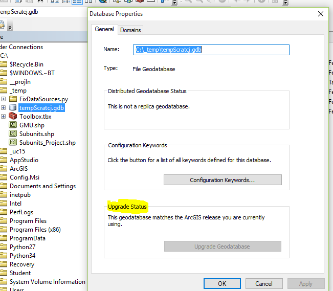

I meant to right-click for the properties in Catalog.  Or is it still not showing up in Catalog?

It should be, but if you see the upgrade button, I would try it (have a backup, of course).  Short of going back to the data owner, and if you have already tried all that was suggested previously, and you tried Resetting your ArcGIS application profile​  then that might be the last thing I can think of to try. The resetting your profile is always a good first try when things go wonky....resets things on your side, in case something it conflicting.
