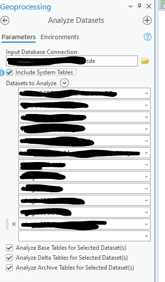

Hi all,
I'm looking into using the Analyze Datasets tool in ArcGIS Pro. Couple questions:
1) Is there a way to pick all Datasets in the geodatabase? Would be nice if we had a select all button here - I have a lot and I haven't picked them all from the drop down yet. I think you all are going to say - use Python. and I'm sure I should but I really just wanted a quick way to run this tool on all datasets.
2) I see Only datasets that are owned by the connected user will be displayed.  So do people end up running this tool at least twice - once as 'sde' and once as the DataOwner user?
