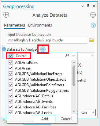

AndreaB_
Now I know why I was looking for the Select All button - because there is one on the Rebuild Indexes pane (see below). Are you aware of any Ideas to make these panes have the same look and feel to 'select all'? or @KoryKramer ? Super confusing to have to 2 different ways (and the help documentation doesn't talk about Select All). If there isn't one then I can start one.
Thank you!

AndreaB_
MarlonAmaya
Hi @AndreaB_ ,
With tool you can select the down arrow and then click the checkbox. yes, this will only display data owned by schema owner and should be ran with "data owner" and SDE user.
AndreaB_
ah ok!! Thank you both!! Never knew that little arrow was there hiding the checkbox for select all. And the rest all makes sense to me. Appreciate it!
